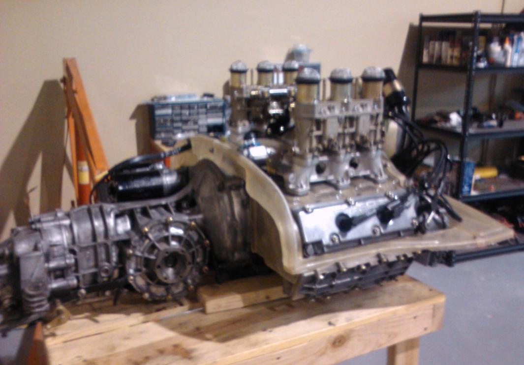

I used simple green and lots of tooth brush sized wire brushes in varios stiffnesses. The brushes came in 3 packs at nearly every local auto parts stores.
After it dried for a few days I went over the whole thing again with just a new set of brushes (dry). Looks clean, but not over restored/polished.
(sorry for the crappy pic)
