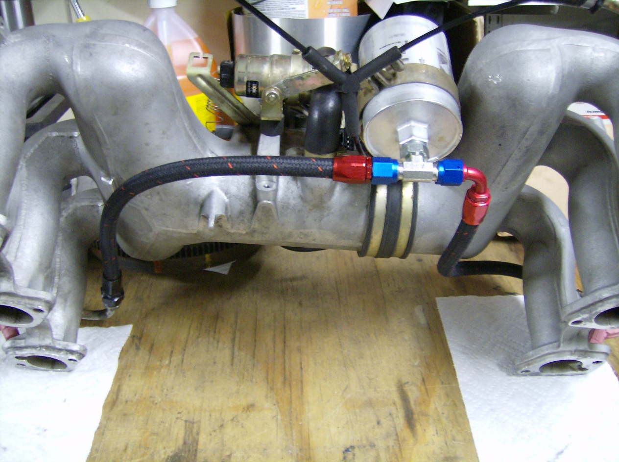

I've been busy this winter working on a couple of projects. My wife thinks I'm nuts because the car was running perfectly well when I put it away.
Project 1 - 3.2 EFI manifold with MS2
The first challenge was to get the manifold to fit. I ended up reversing the manifold which worked better for my purposes.
1. Repurposed the heater fan motor bracket to hold the fuel filter vertically behind the manifold. There is now a metric to AN tee off the bottom of that filter that feeds both fuel manifolds.
2. I had to drill my nice powder coated tin to run the cable up through, but it was worth it. This is a 6" longer than stock cable from Terry Cable. The cable is mounted to the old cruise control throttle bracket with a small square to round adapter. I just needed to make a new throttle bracket to connect the cable up.
Just need to finalize a bracket or two and shorten the intake tube a couple of inches.

tomeric914   I've been busy this winter working on a couple...   Mar 25 2012, 09:54 AM
