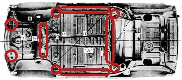

With all this talk of our cars on jack stands, i was wondering the best spots for the stands to be placed. I usually place the front pair right back of the front wheels, in the side channel on the floor (right inside of the rocker panel). The rear set, i put underneath the engine mountaing bar. Car seems balanced (doesn't move when i'm hauling my 300 pound carcass in and out while bleeding the brakes), i just wonder if it is the best spot.

Here it is.
roundboy914   Jack Stand Locations   May 19 2004, 08:26 PM
ChrisReale   I put the rears on the engine mount bar and the fr...   May 19 2004, 08:32 PM
415PB   <...   May 20 2004, 12:50 PM
i love porsche   heres the page from the article in Excellence of t...   May 20 2004, 01:25 PM
tat2dphreak   that looks like it's pointing to the donuts......   May 20 2004, 02:10 PM
watsonrx13   Wayne, I use the donuts on the front. This also sh...   May 20 2004, 03:44 PM
watsonrx13   Here's a shot of them holding up the rear.   May 20 2004, 03:45 PM
watsonrx13   Finally, here's a shot of all four. I have had...   May 20 2004, 03:47 PM
tat2dphreak   mine look very similar to those, made by "cat jack...   May 20 2004, 04:04 PM
Dave_Darling   Do a search... I doctored a pic of the underside ...   May 20 2004, 04:21 PM
Curvie Roadlover   DD, I remember that pic. Any way you could dig it...   May 20 2004, 06:40 PM
STL914   Here it is.   May 20 2004, 06:48 PM
Curvie Roadlover   Thanks Gary :trophy:   May 20 2004, 07:11 PM
tat2dphreak   wow, thanks for the info! I just got back from...   May 20 2004, 07:20 PM
