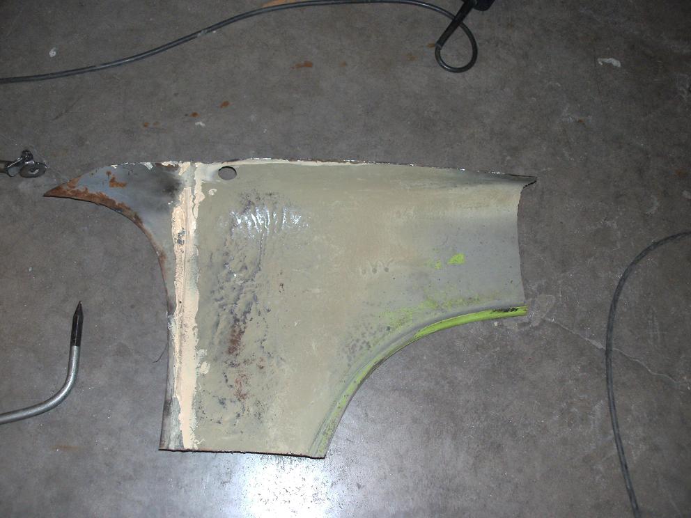

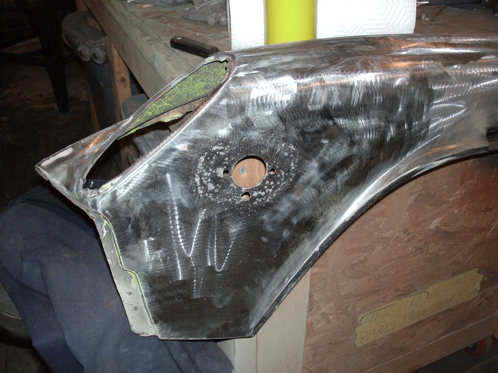

Here is the fender That I cut off. The damage was deep with no room to swing at it. I tried to heat it with a torch and push it out while it was hot. This worked to the point where I ended up with a reasonable amount of damage to fill but when I was shrinking it flat I ended up shortening the fender leaving a door gap 8mm wide. The wrinkles you see I couldn't hammer. no room. (IMG:style_emoticons/default/dry.gif) Not every repair technic is going to work in every situation. ![]() Here is the MN donor fender. The bottom had a brazed patch that had rusted out again. After cutting off the lower section I ended up with a good piece or so I thought. Once I started cleaning up the rest of it, I discovered that the side marker light hole had a huge rust ring around it. The rust ring around it with pin holes through it and as John suspected the weather stripping channel was not much better. The section I ended up using was very nice and I am satisfied I put the car back in a condition that will not devalue it. It really is a solid car and were happy to be the lucky owners. ![]() |
