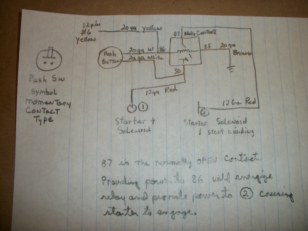

Well, now that I have the fuse block kits all done, I had time to get back to my project. Have the relay and push button mounted, now have to draw a wiring diagram and get the wires installed. It fits under the cover just fine!
Tom
EDIT: the wiring diagram is done.

Valy   Tom very nice but a word of advise: Please, put a ...   May 15 2012, 01:20 PM
jim_hoyland   Like your idea, very clean installation. If the wi...   May 15 2012, 04:33 PM
Tom   Jim, With the key off, the coil has no power ...   May 15 2012, 07:08 PM
jim_hoyland   Please post the schematic, the parts list, and ins...   May 15 2012, 07:33 PM
Tom   Jim, I'll put an updated schematic tomorrow...   May 15 2012, 09:22 PM
Tom   As you can see from the pictures the large yellow ...   May 16 2012, 06:15 AM
Tom   Additional pics for illustration purposes. To...   May 16 2012, 06:18 AM
Tom   more. Even though this is first gen of this m...   May 16 2012, 06:20 AM
jim_hoyland   Am I correct that the relay will be used by both t...   May 16 2012, 08:49 AM
Tom   Jim, Yes, the relay works for both the key swit...   May 16 2012, 08:58 AM
