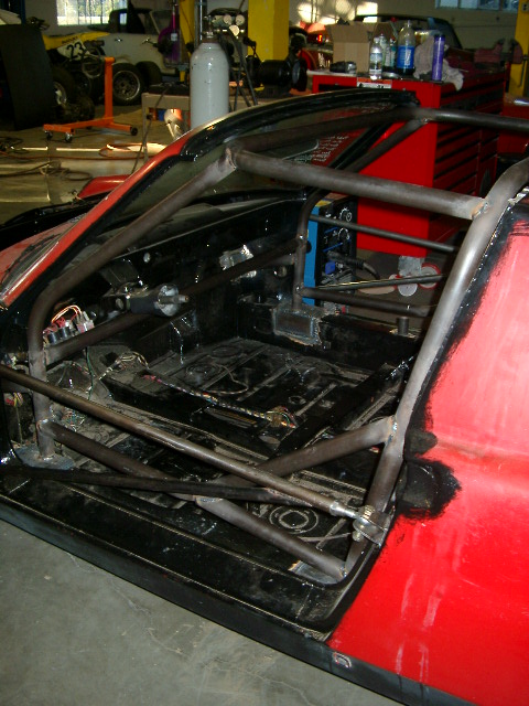

Seems like adding a short tube, elbow to crotch, would make a big difference in that example. The bend with no support is sketchy. Wait, the more I look at that, the more it bugs me. The bend is bad. It would be better to make the side tube straight and connect it lower to the rollbar than bend it like that. Ugh, we are venturing outside best design standards. Bends are for hoops. Tubes between pillars should be straight and triangulate. Hey I'm a poet and don't know it.
post Dec 2 2010, 12:03 PM
Resident German
Posts: 42,483
Joined: 21-January 03
From: Oakland, Kalifornia
Member No.: 179
QUOTE(Rand @ Dec 1 2010, 09:20 PM) *
Here's what Tony did on my cage. Ignore the temp bracing ...
(IMG:http://www.914world.com/bbs2/uploads/post-179-1210447317.jpg)

If you're street driving you're more likely to get bonked on the top bar (back hoop to front hoop) than the front.
My original cage was like yours and there was nothing, in the form of restraints, to keep my head from hitting that back to front top bar. The big racing belts I use would keep your head from going forward and hitting the front hoop, but guessing most don't use the shoulder harnesses on the street as they aren't very comfortable if cinched tight. Most just use the lap belts.
I like the cage I have now in that there is nothing high in the front (you can see) and the side bar is pretty hard to hit even if you try. Of course you might not want to cut your windshield off. (IMG:style_emoticons/default/smile.gif)
