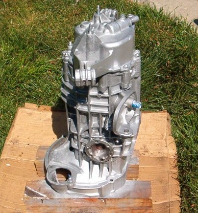

(IMG:http://www.914world.com/bbs2/uploads/post-11106-1334455454_thumb.jpg)

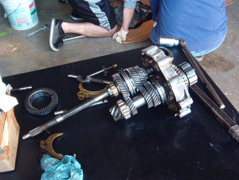

But the doc walked us through everything and supplied the critical tools to get it all done!

The Doc will look at your syncros and sort them from best to worse and you install them on the gears that get used the most- first, second, third. And the not so good ones on 4th and fifth. You may need to buy a syrncro or two. Also the Doc will change teeth on the gears and this may cost you.
The Doc will flip gears for you or install different sets.

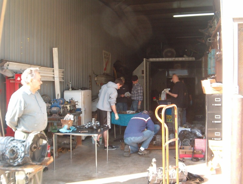

Philip W.   Here is billh1963! If you look close you will ...   Apr 16 2012, 02:19 PM
Philip W.   Reassembly went quick,! With doc's help. W...   Apr 16 2012, 02:29 PM
