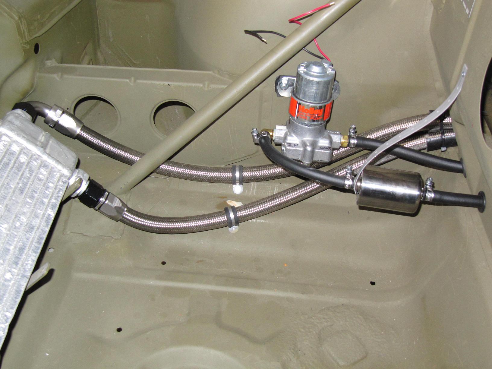

Got my oil lines and fuel system done! Mazda RX-7 cooler and Holley red fuel pump. Stainless fuel lines courtesy of Tangerine Racing. I have both installed even though I only am using one now.

Krieger   Got my oil lines and fuel system done! Mazda R...   Apr 20 2012, 11:18 PM
Krieger   I ran the lines in the long and wrapped them with ...   Apr 20 2012, 11:21 PM
Krieger   The left engine compartment view. Yes the line is...   Apr 20 2012, 11:24 PM
Krieger   Here is the right side detail. with my home grown ...   Apr 20 2012, 11:31 PM
