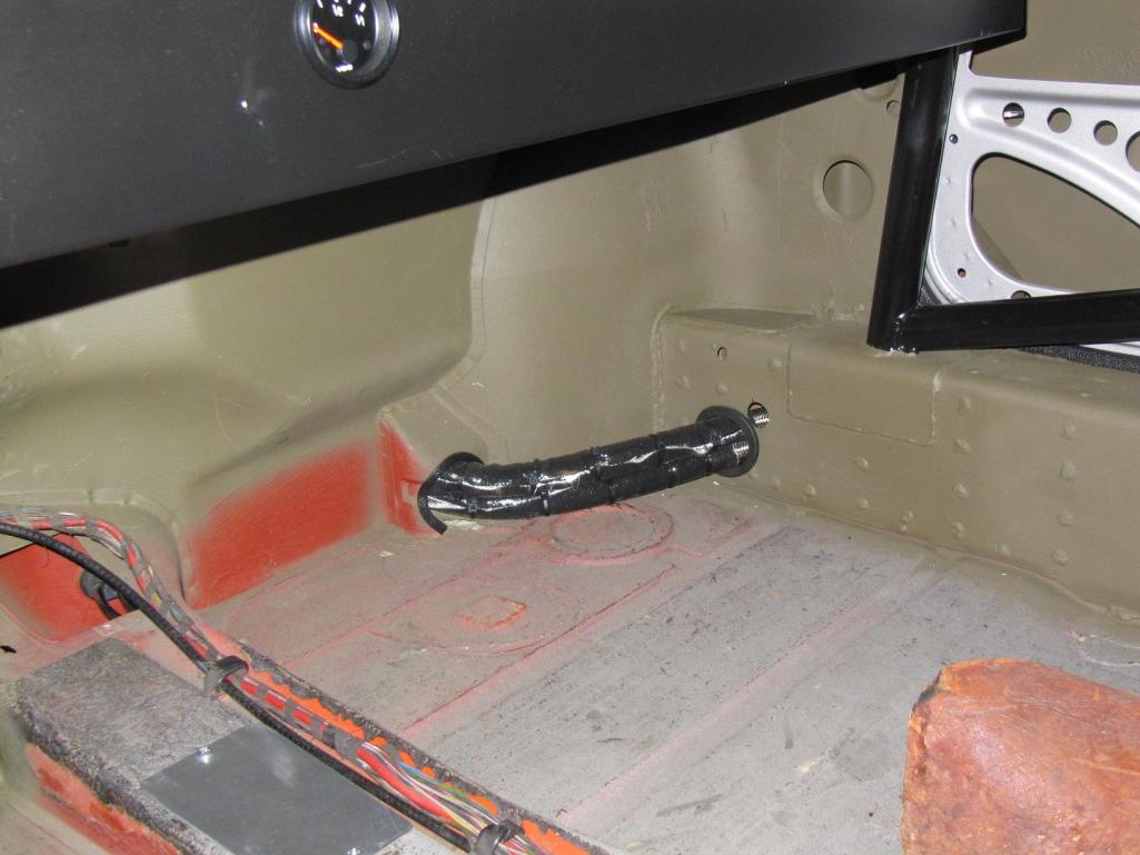

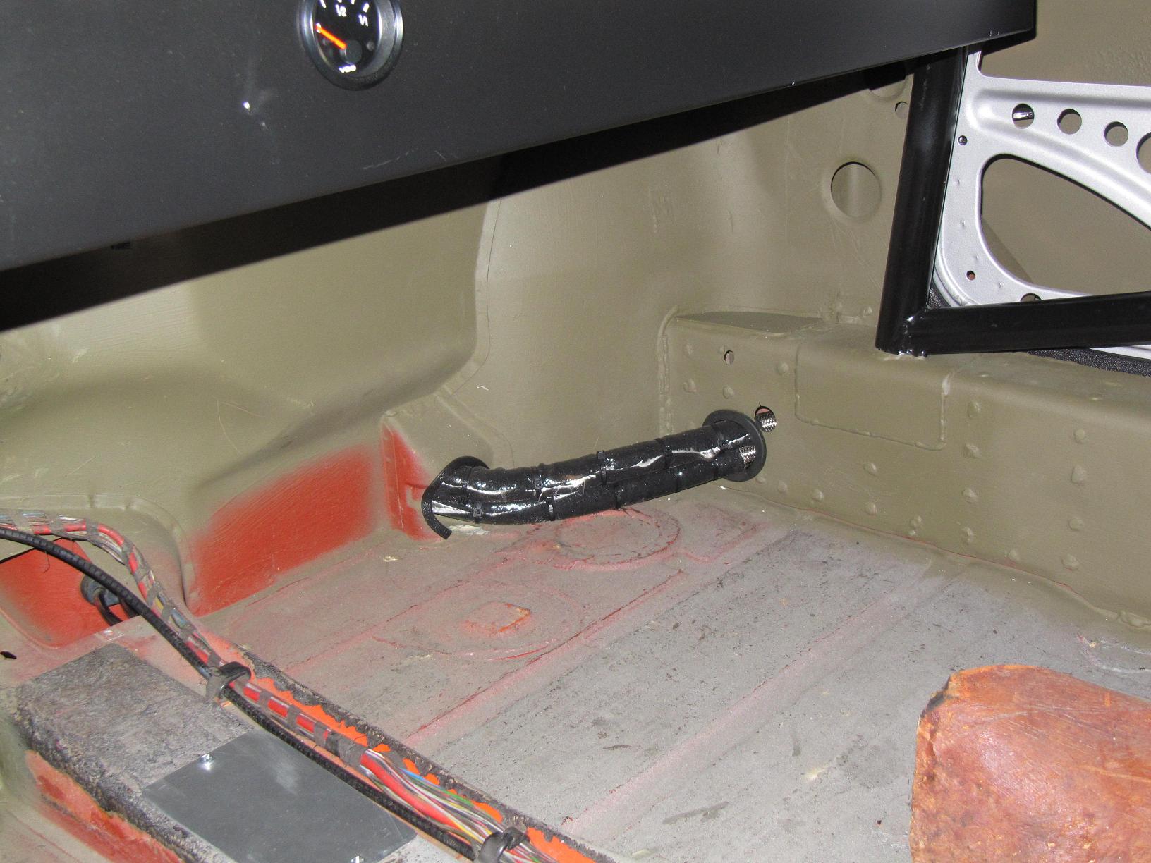

I ran the lines in the long and wrapped them with a heat insulating material. A little bit of work with a hole saw and grinder.

Krieger   I ran the lines in the long and wrapped them with ...   Apr 20 2012, 11:21 PM
