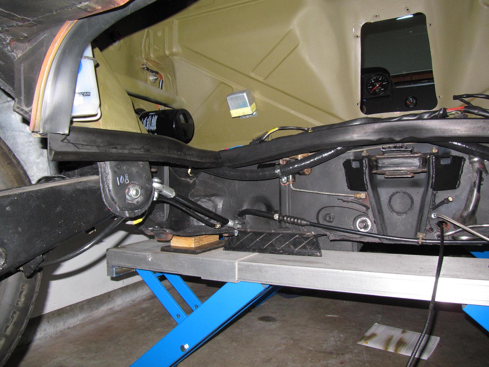

The left engine compartment view. Yes the line is run over the stock 6 engine mount, then fastened to the brake dampner. GT style engine mount bracing encouraged by Mr. Eric Shea.
