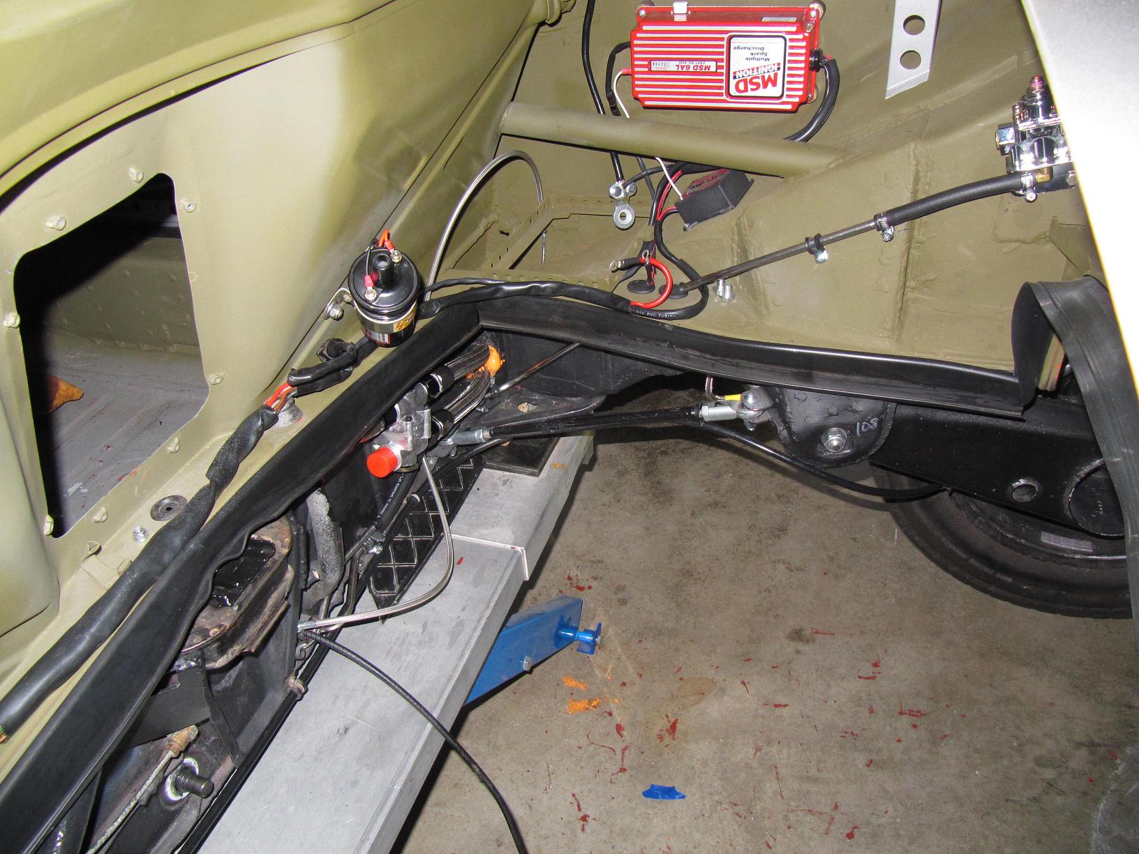

Here is the right side detail. with my home grown battery tray....wait till you see my "hot rod' style battery hold down. All the ignition components are wired into the body harness.

Krieger   Got my oil lines and fuel system done! Mazda R...   Apr 20 2012, 11:18 PM
Krieger   I ran the lines in the long and wrapped them with ...   Apr 20 2012, 11:21 PM
Krieger   The left engine compartment view. Yes the line is...   Apr 20 2012, 11:24 PM
Krieger   Here is the right side detail. with my home grown ...   Apr 20 2012, 11:31 PM
