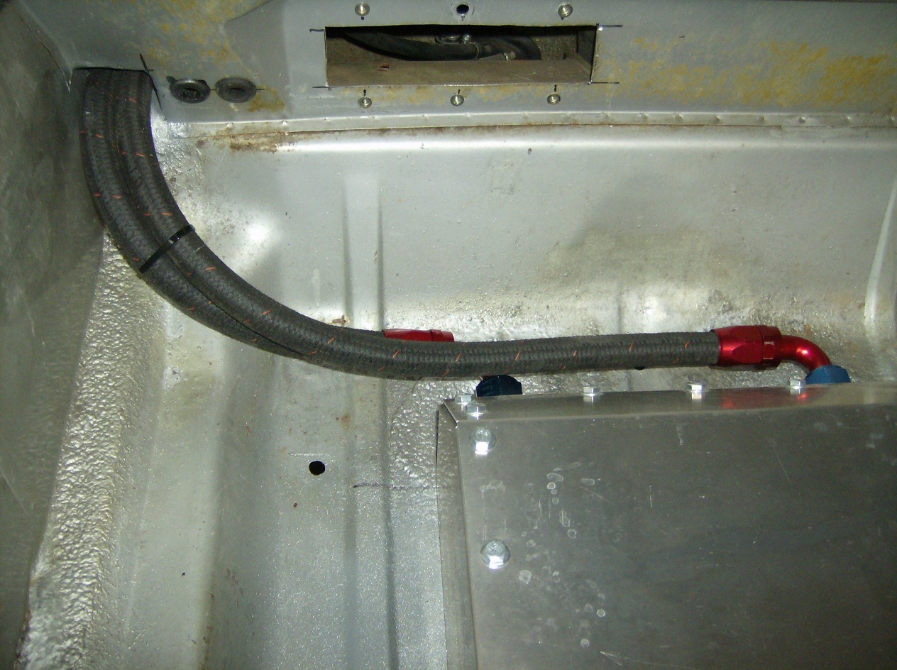

I finally got the oil lines run front to back running through the heater ducts in the long and took a few pictures that may help others in the future.

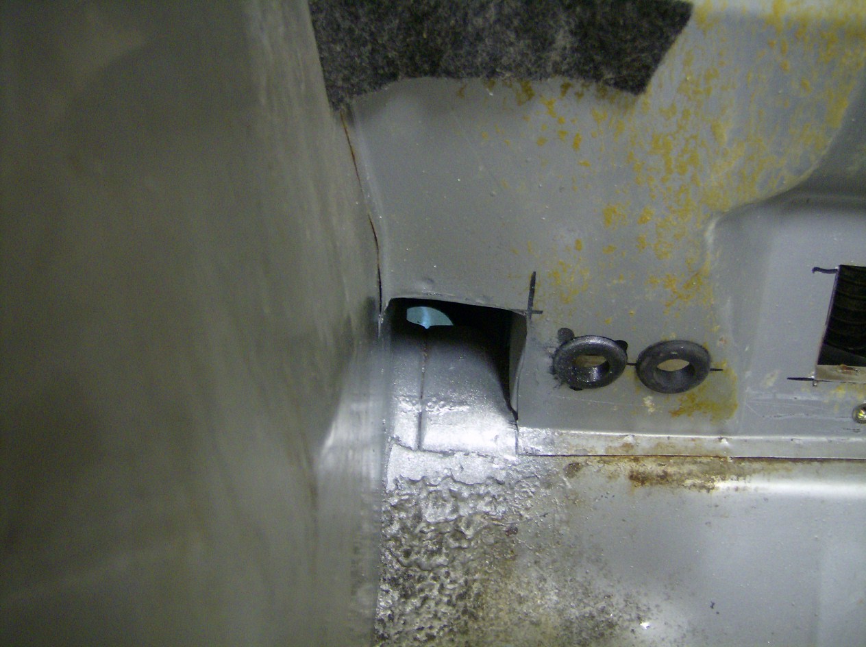

This is up front on the passenger side in front of the gas tank taken without a flash to show that the path is fairly clear to the inside.

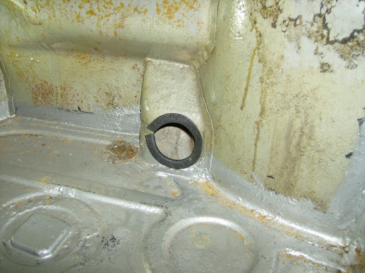

Next is at the passenger footwell. I used a 2-1/4" hole saw and used some TrimLock to cover the sharp edges.

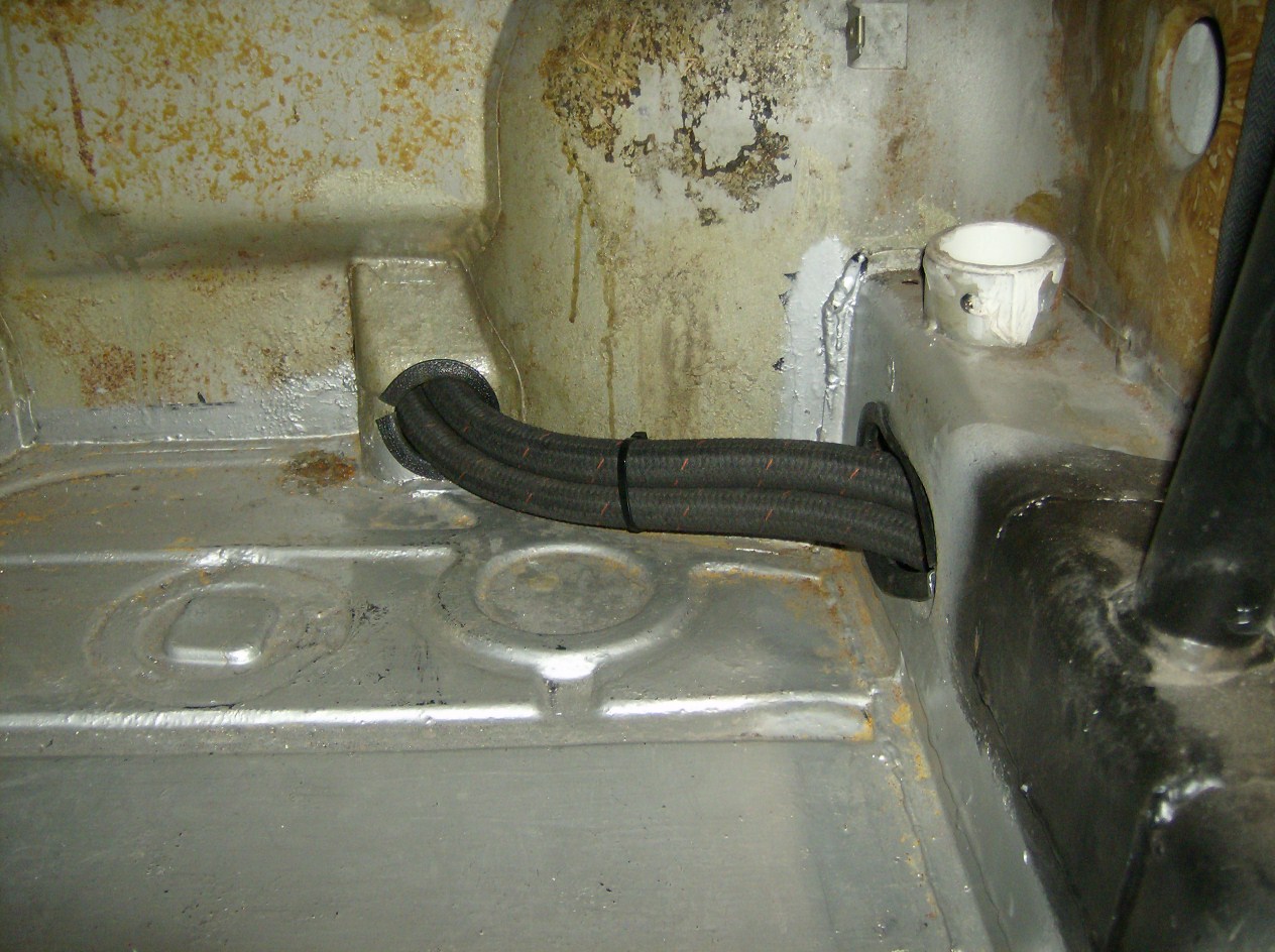

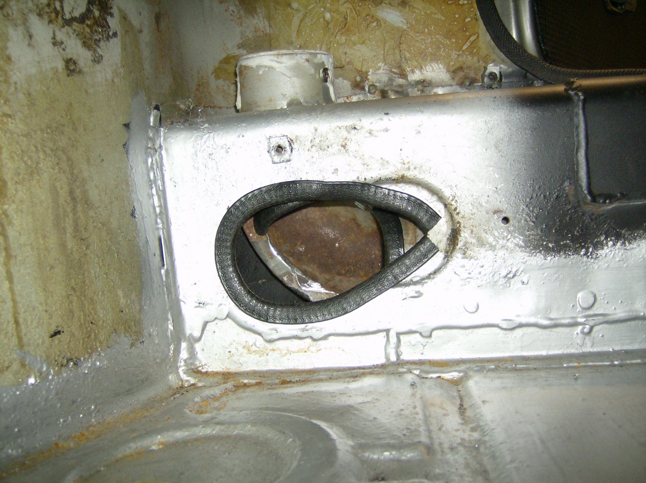

Cutting the long is the PITA of the hole process. I drilled once with the same 2-1/4" hole saw cutting through the long sheet metal and then into the elbow duct inside the long. Then I used the hole saw again to cut another half hole further forward so the hose radius was smooth. TrimLock was used on the long and the duct inside the long to protect the hose.
Final after the hose was run
