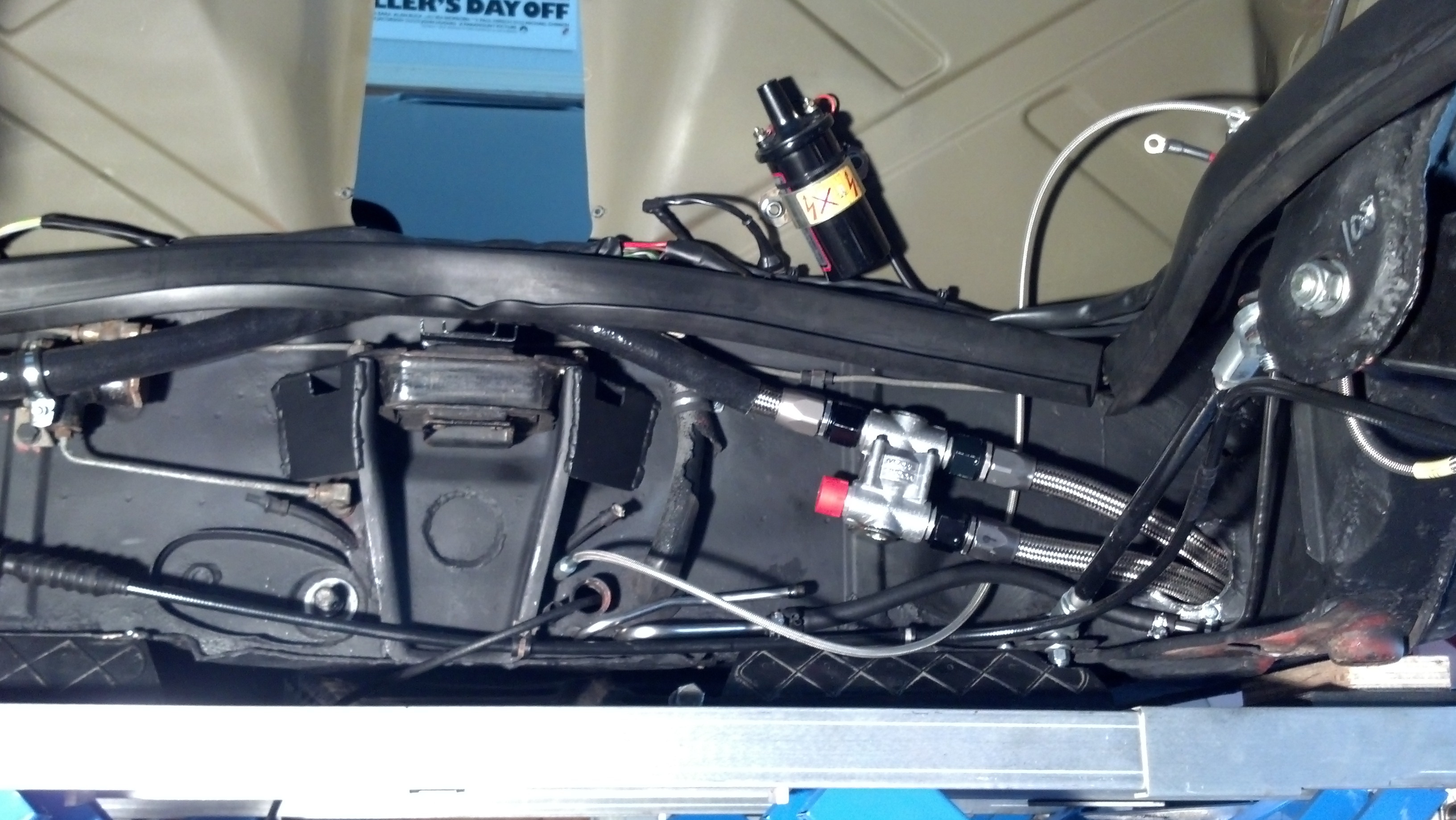

A better view of oil thermostat and line routing.

Krieger   A better view of oil thermostat and line routing.   Apr 22 2012, 08:06 PM
