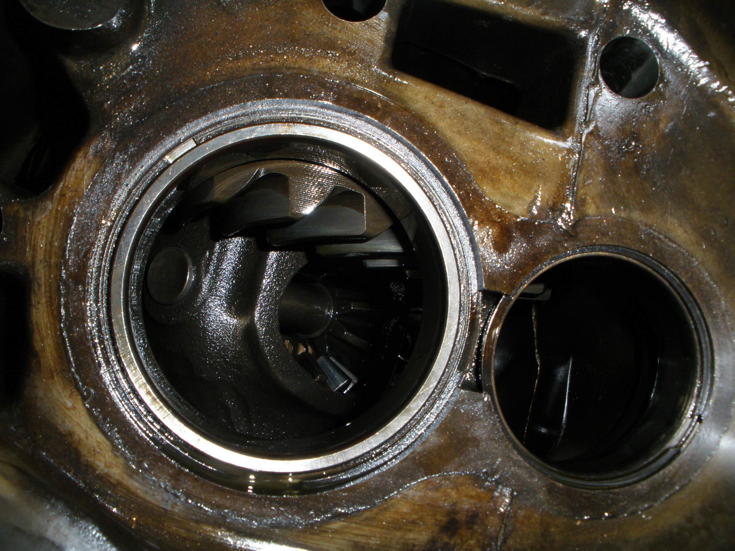

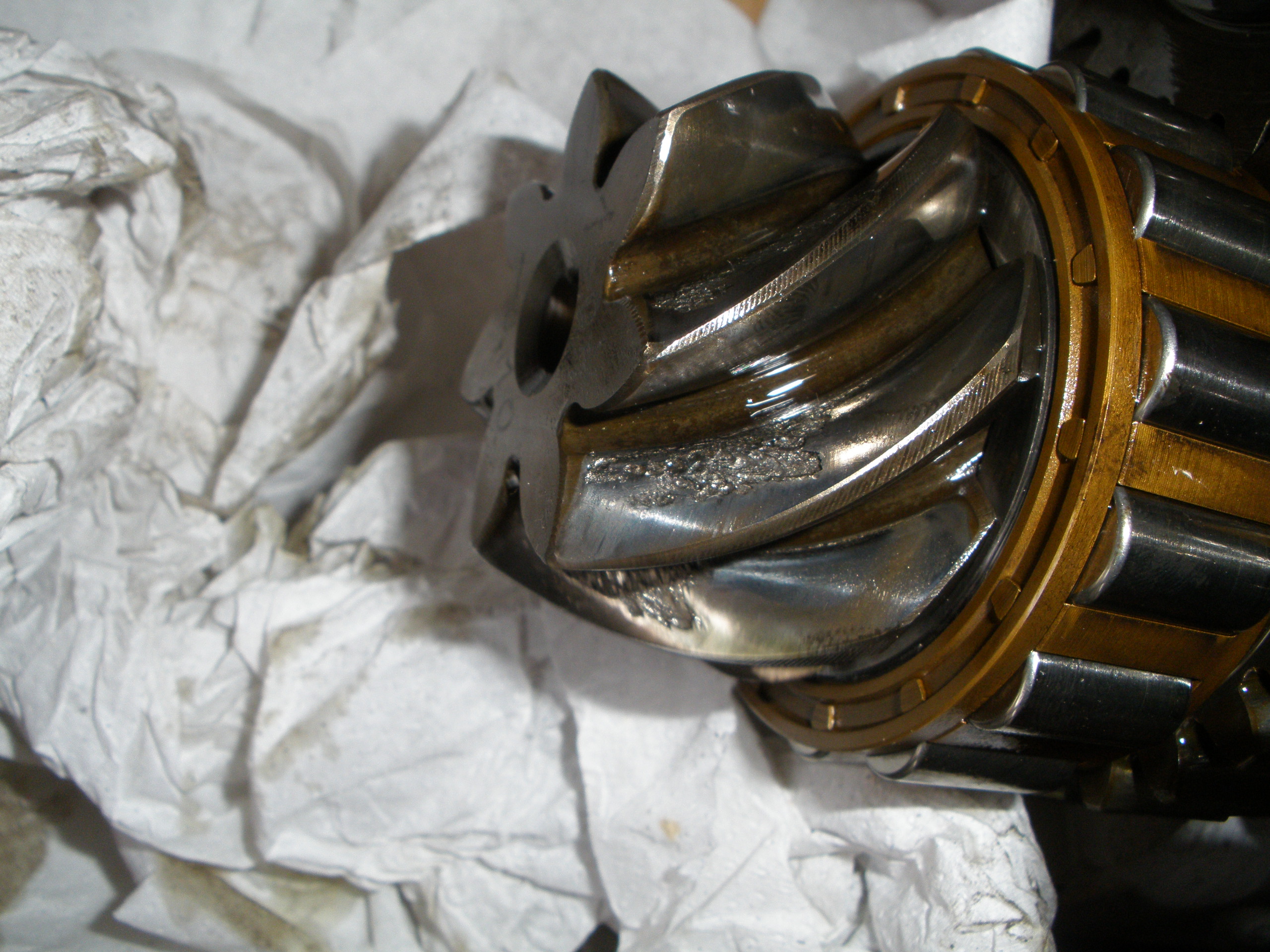

I continued my transmission rebuild and have additional questions. First I like to show bad news. I think the root cause is cavitation caused by ??.
The number for the ring gear and pinion shaft is the same. The roller bearing outer part can be rotated in the case.. ist this normal.. the manual says different.
Is there a need to solve this and If how?
I also have now the problem to get a used ring gear and pinion shaft.
The clearances must be adjusted again, I do not have the tools. Are there different approaches to do this without these tools?

Dr Evil   That is toast. The race in the case should not mov...   May 15 2012, 06:50 AM
914Gelb   So, it'S not possible to get ring and pinion i...   May 15 2012, 07:04 AM
Richard Casto   Georg, Regarding the bore for the roller bearing,...   May 15 2012, 02:17 PM
Dr Evil   I agree that another core would be a better invest...   May 15 2012, 02:55 PM
914Gelb   Thanks for the answers! I also think it makes...   May 15 2012, 11:35 PM
Dr Evil   There is another alternative to changing cases. Th...   May 16 2012, 06:38 AM
914Gelb   I will measure the outer race of the bearing, do I...   May 20 2012, 01:24 PM
Dr Evil   Yes, the bearing should be replaced as a unit to b...   May 20 2012, 02:46 PM
