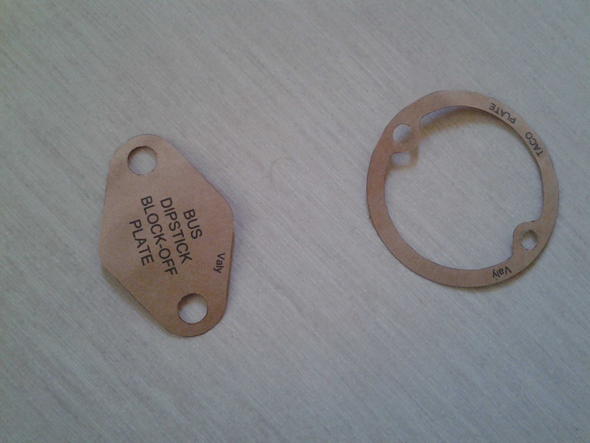

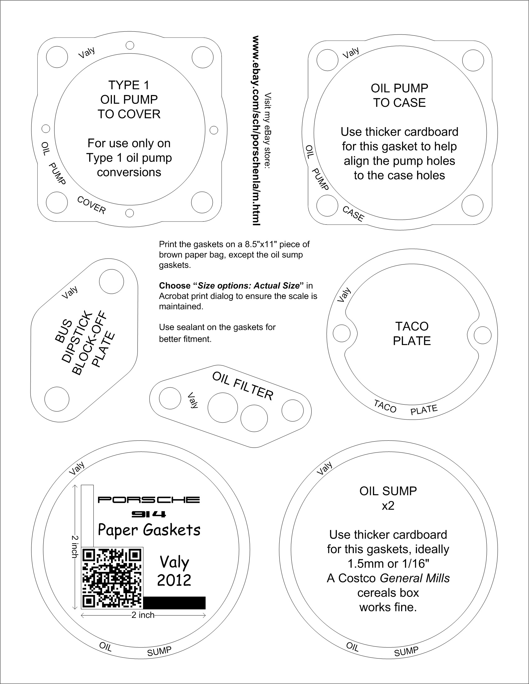

Gaskets
I had to make a thicker gasket for my oil pump to align it better with the case oil galleys.
I also had to make a gasket for my Bus dipstick block-off plate (I have a universal replacement case)
I had an old template for the oil sump gaskets on hand as well so I decided to combine all of them in one template and add the remaining gaskets as well.
A brown paper bag works perfectly for the thin gaskets.
For the thicker ones, I used a cereals box. The Costco one was better since the cardboard is a bit thicker as the box is bigger. Always use sealant on the gaskets for better fit.
I recommend to use the PDF version for better print scaling.
