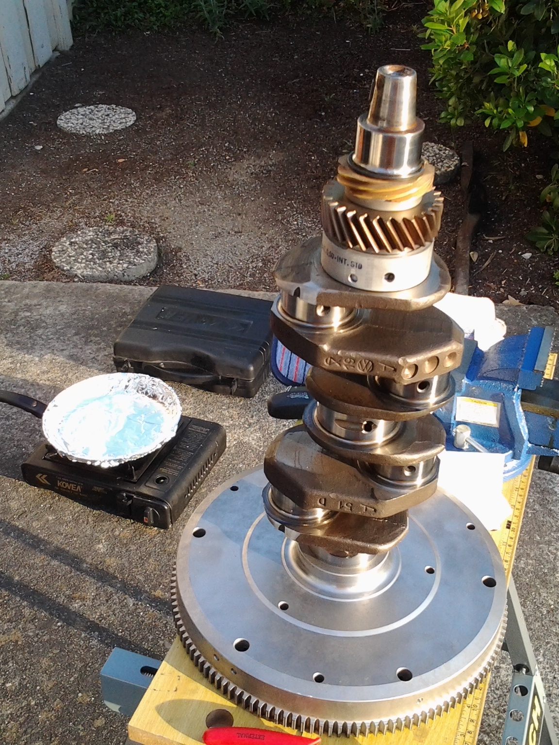

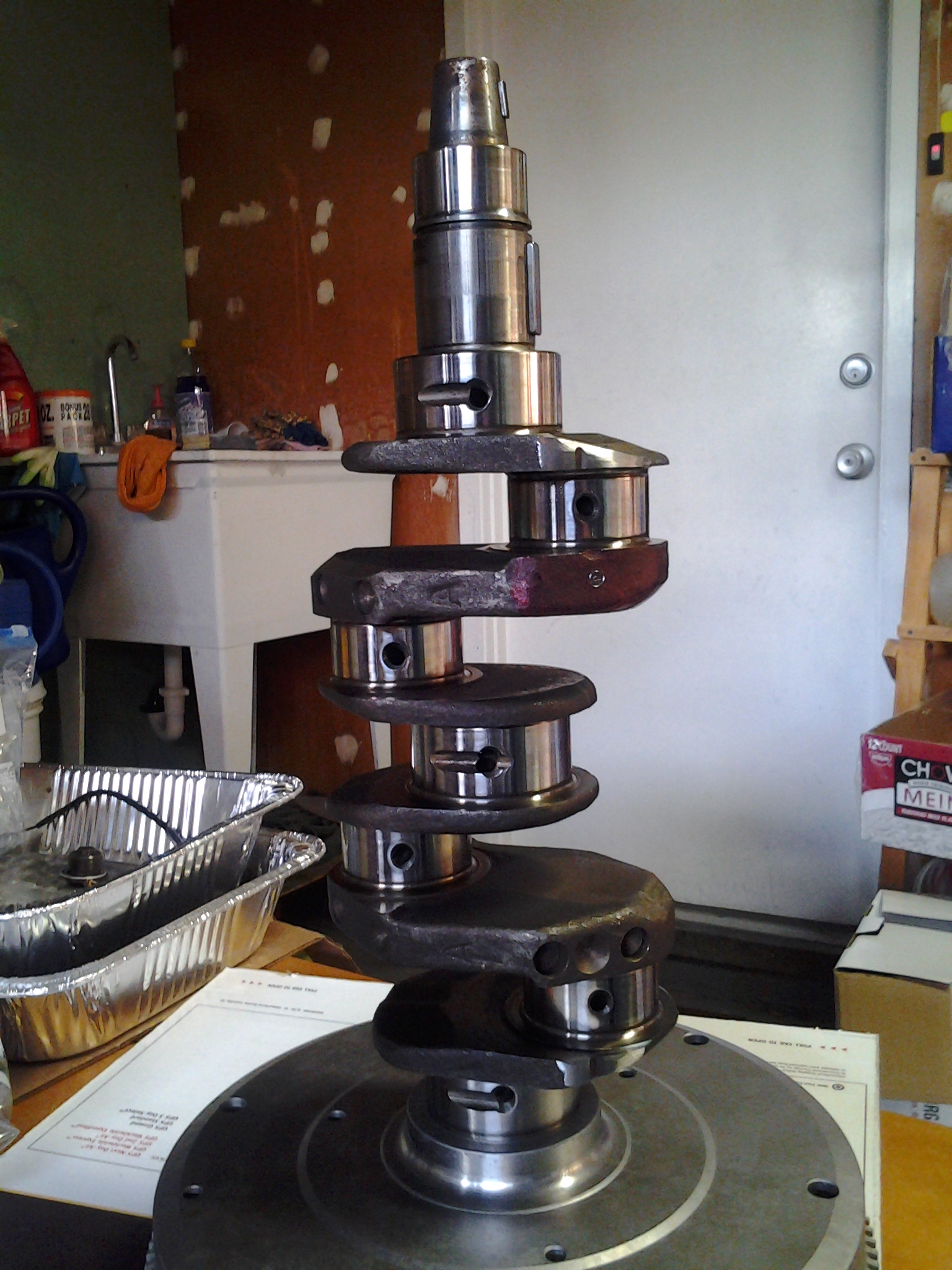

Crankshaft
I re-built the crankshaft assembly.
The crank is a 2.0L 71mm STD crank. It was polished and balanced together with the fan, flywheel and clutch.
I used the flywheel as a stand and fixed the crank into it in vertical position.
I gave it a good cleaning, including inside all the oiling passages.
I heated the camshaft and dizzy gears on a small camping stove I had nearby and then mounted them on the crank.
The big c-clip was a PITA to fit but I finally got it in there.
