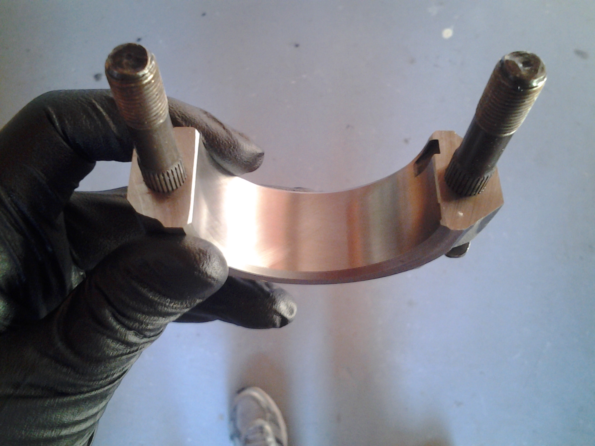

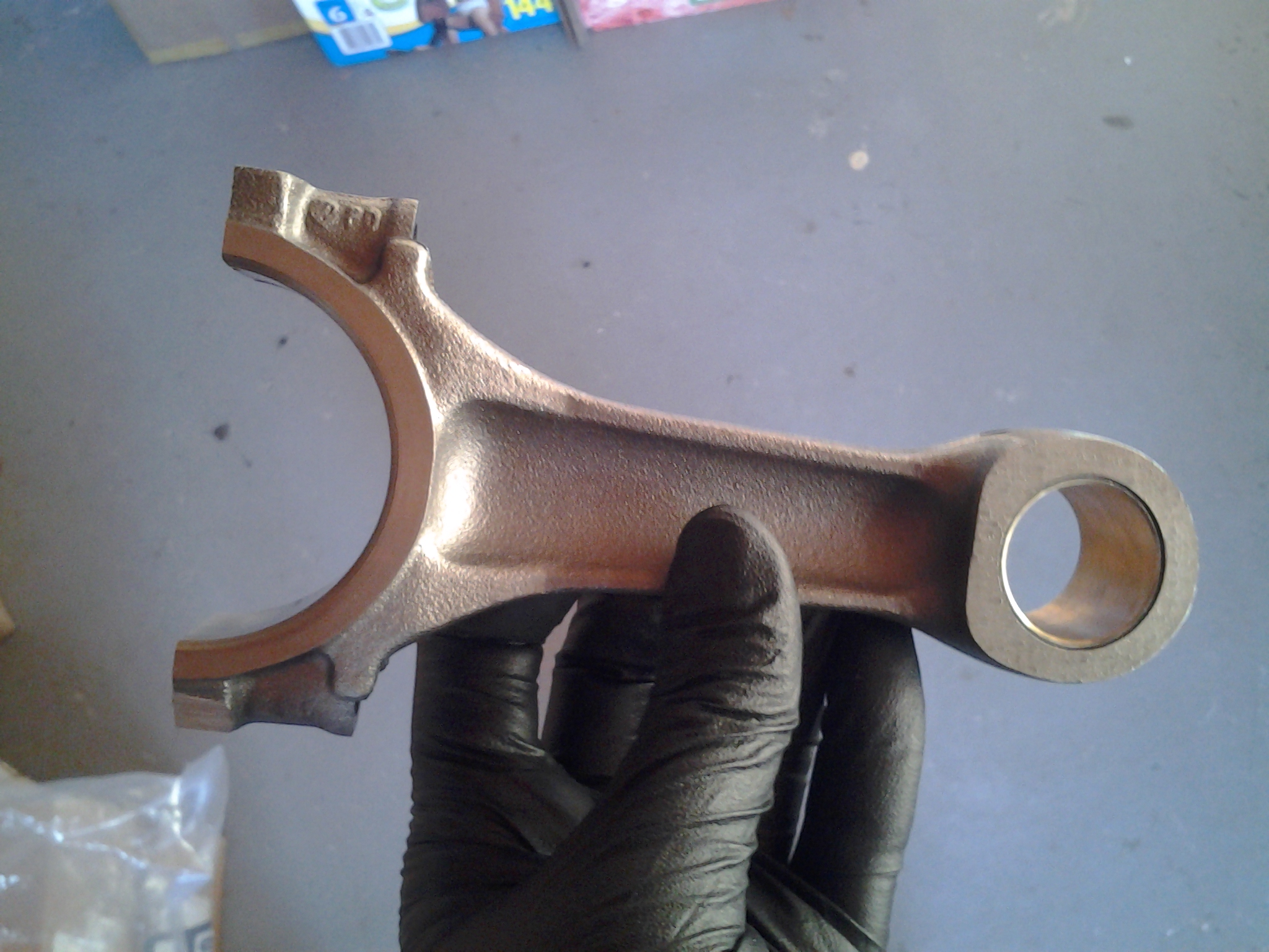

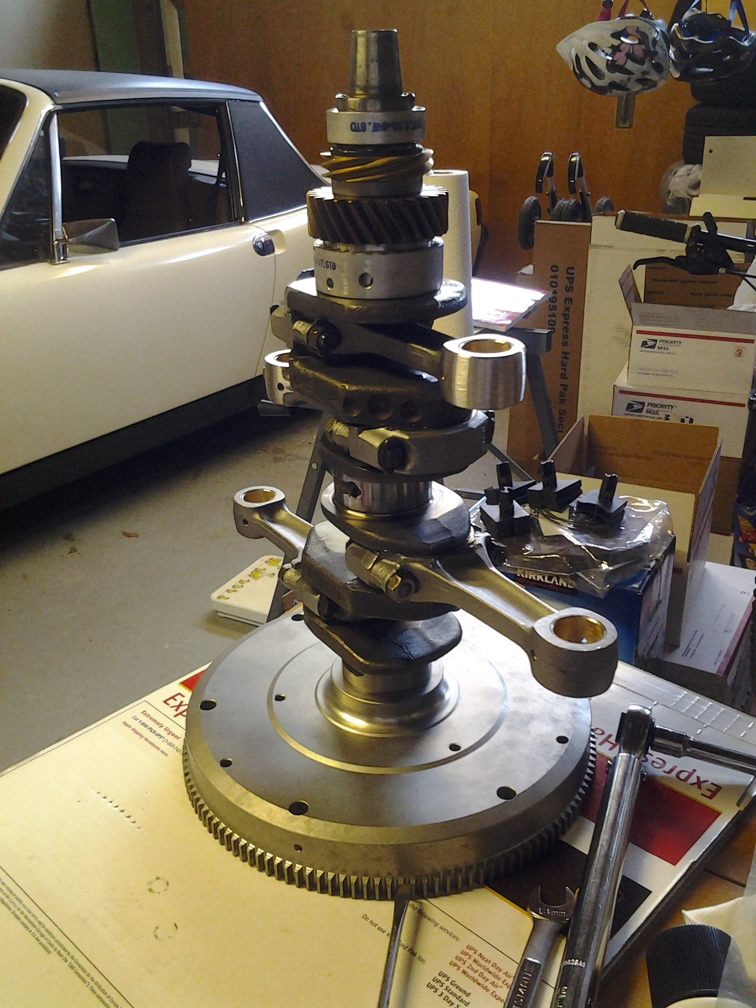

Connecting Rods
I had the connecting rods reconditioned and re-balanced. They turned out very nice. See the difference between the before and after pictures.
I cleaned them well and installed the new bearings. Then I lubricated the journals and bearing and installed the rods on the crank.
Rod before:
Rod after:
