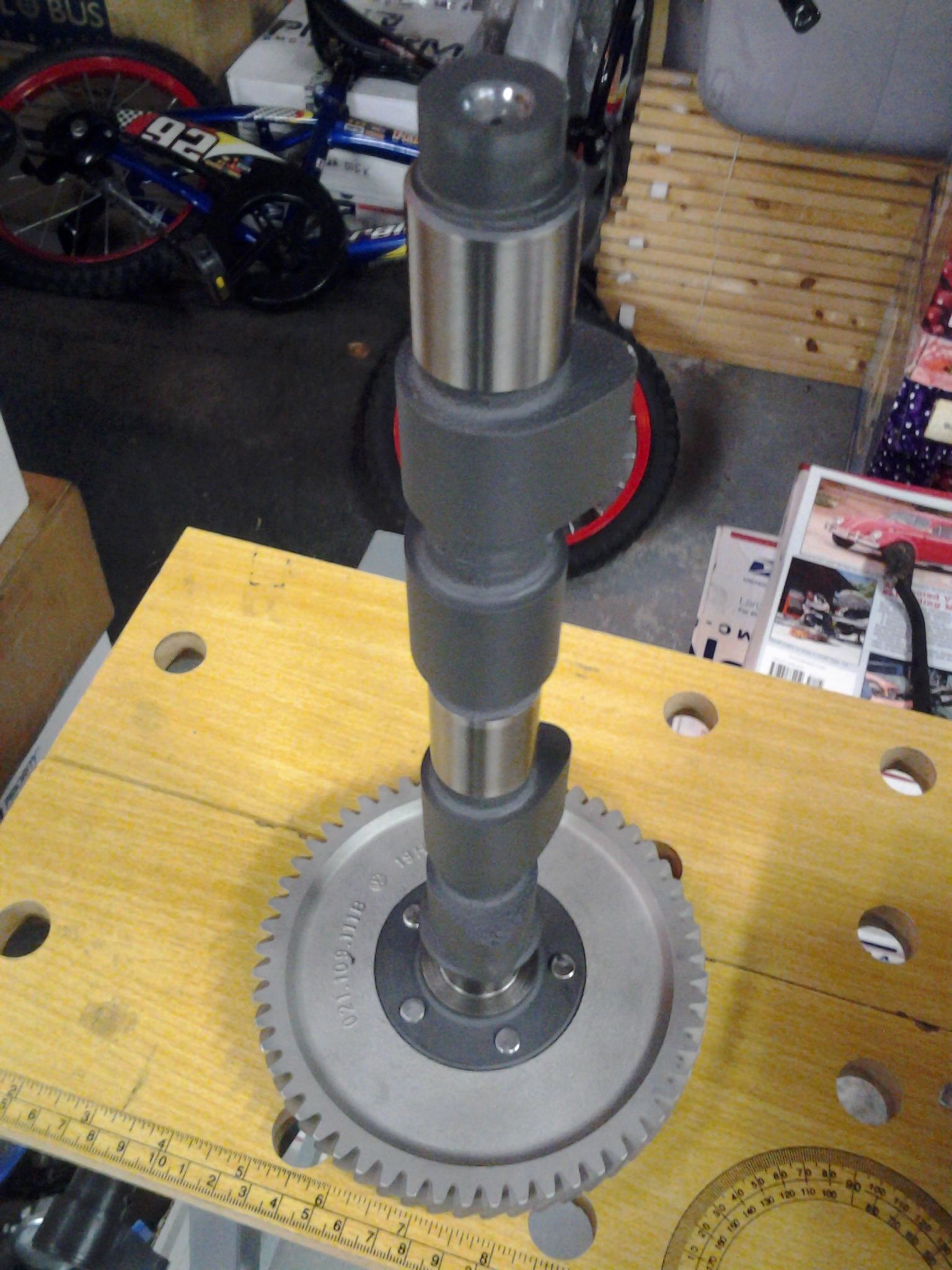

Camshaft
I'm using a new camshaft. This is special cam I ordered from Webcam, similar to their #73 but with a longer duration on the exhaust to help the gases escape and keep the heads a bit cooler. It also improves the performance just a bit.
CODE
                     | Intake   | Exhaust
Valve Lash (Inch):   | 0.006"   | 0.006"
Valve Lift (Inch):   | 0.426    | 0.426
Valve Lift (mm):     | 10.82    | 10.82
Advertised Duration: | 262°     | 267°
Duration @ 0.050":   | 224°     | 229°
Lobe Center:         | 108°     | 108°

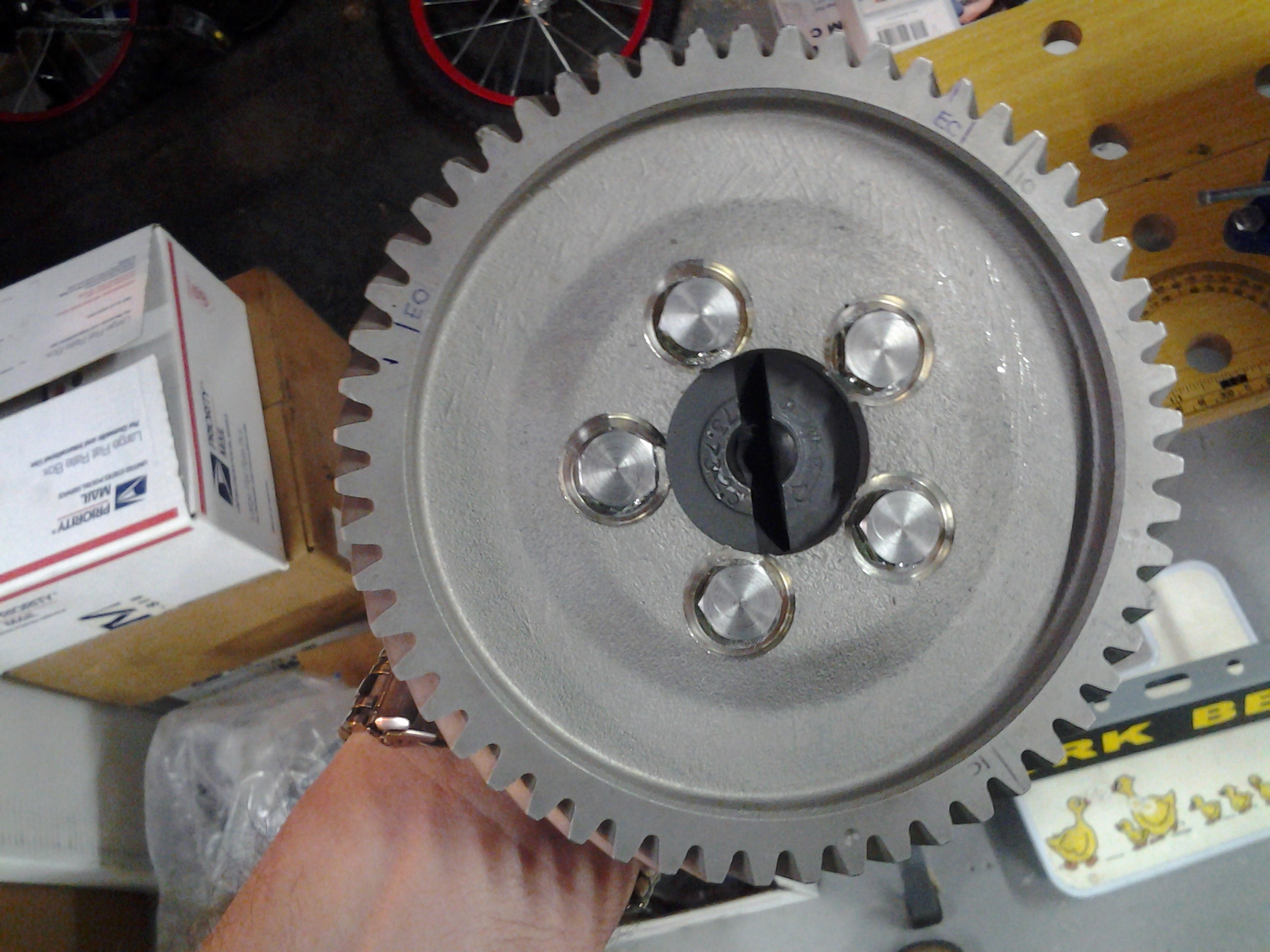

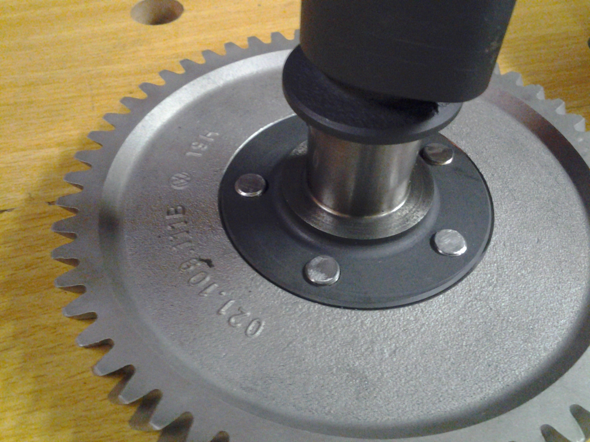

The new camshaft needs to be bolted to the cam gear. I had the cam gear holes clearanced for the bolts heads. The cam came with bolts that have a smaller head thickens to help clear the oil pump.
I had to trim the bolts length a little to clear the case on the back of the cam gear.
After all the dry measurements, I added a bit of thread locker to the bolts to make sure they don't come loose.
