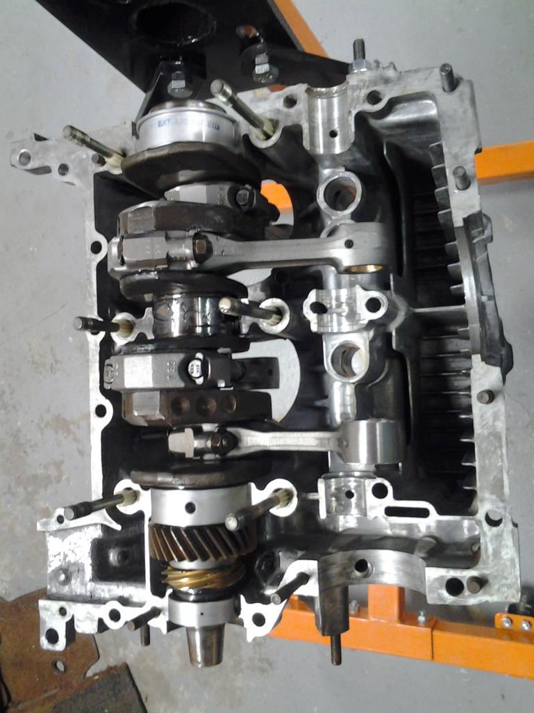

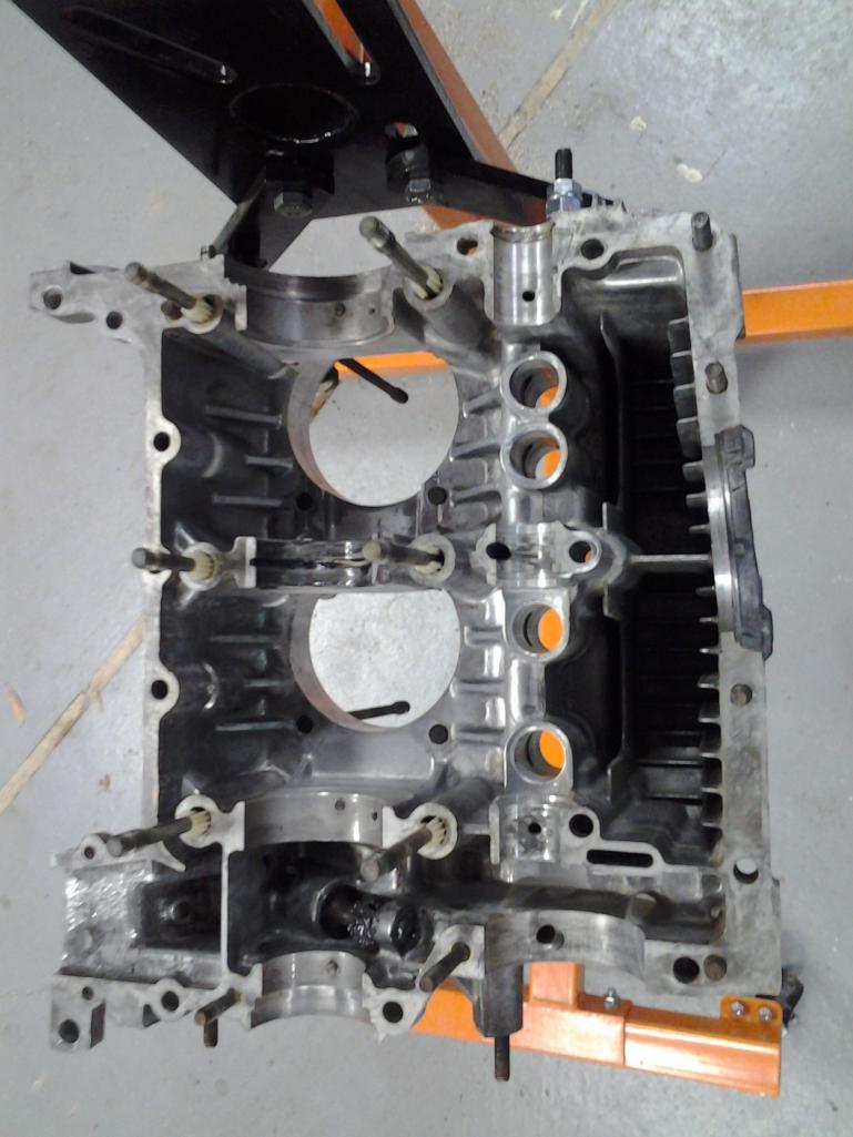

Half Case Assembly
Mounted the distributor gear with the special oiling washer and the dizzy into the case.
Installed the six through bolts with their plastic centering spacers.
Then cleaned, installed and lubed the split bearing.
I cleaned, lubed and installed the other bearings on the crankshaft and installed the crank into the case.
The bearings aligned quite easy. The smaller one was more stubborn but finality went in.

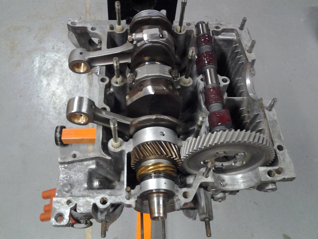

Similar process for the camshaft:
Cleaned and installed the camshaft bearings, lubed them with assembly grease, lubed the cam lobes with the very thick grease supplied with it and then installed it into the case.
