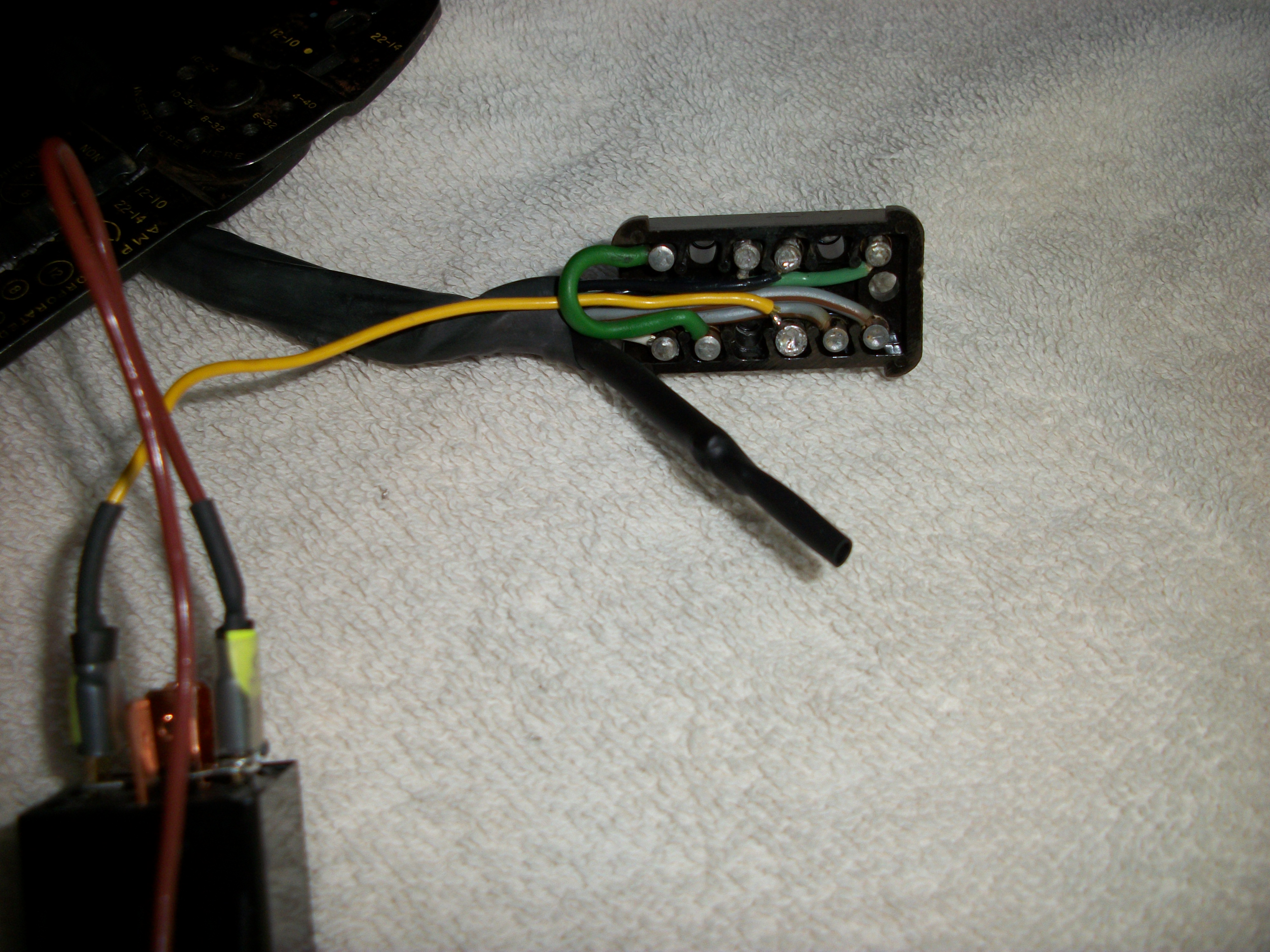

Well, been meaning to get this done for a while. Didn't want the hot start kit from Bosche or the Ford relay, so I found one on line that I liked.
Installed the relay on a small bracket on one of the mounting screws for the relay board. Ran a new small yellow wire to pin 6 of the 12 pin connector and a brown ground wire to the bracket . Ran two 12 ga. wires fron the relay to the solenoid with the hot wire having an inline water resistant ATC fuse holder with a 30 amp fuse. Put some heat shrink around the normally used large yellow wire to protect it. On the solenoid side used tape to protect the connector that used to be hooked to the solenoid.
This relay uses 140 mili-amp so not a very large inductive spike to worry about, but I installed a supression diode across the relay coil anyway. Also put a larger one across the solenoid coil at the relay ( 87 to ground). This supresses the solenoid coil inductive spike to protect the relay contacts.
here are a few pics, and a link to more info: http://www.google.com/url?sa=t&rct=j&a...eg_6KDxZdKYQYGw This is the aeroelectric link
Oh, I tested it several times and it works just fine.
Tom
Edit: changed back EMF to inductive spike, sorry if this confused anyone. Inductive or transient spike is the correct term for what is happening here

more.
Even though this is first gen of this mod, you can see the pin 6 now has a smaller yellow wire and the large yellow wire has been insulated.
I think that should be enough to show anyone who would think of doing this mod what amount of work is envolved. Make sure you get the relay board end completed first, run the heat shrink over the two red wires leaving plenty of room for the starter end's work to be done. Shrink the first piece of heat shrink, then after cooling put another piece up over the first one that can be slid back and shrunk after the starter end's work is completed.
Tom
