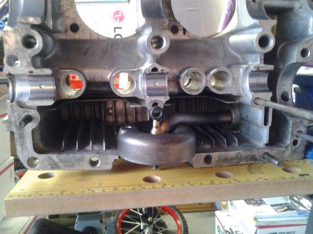

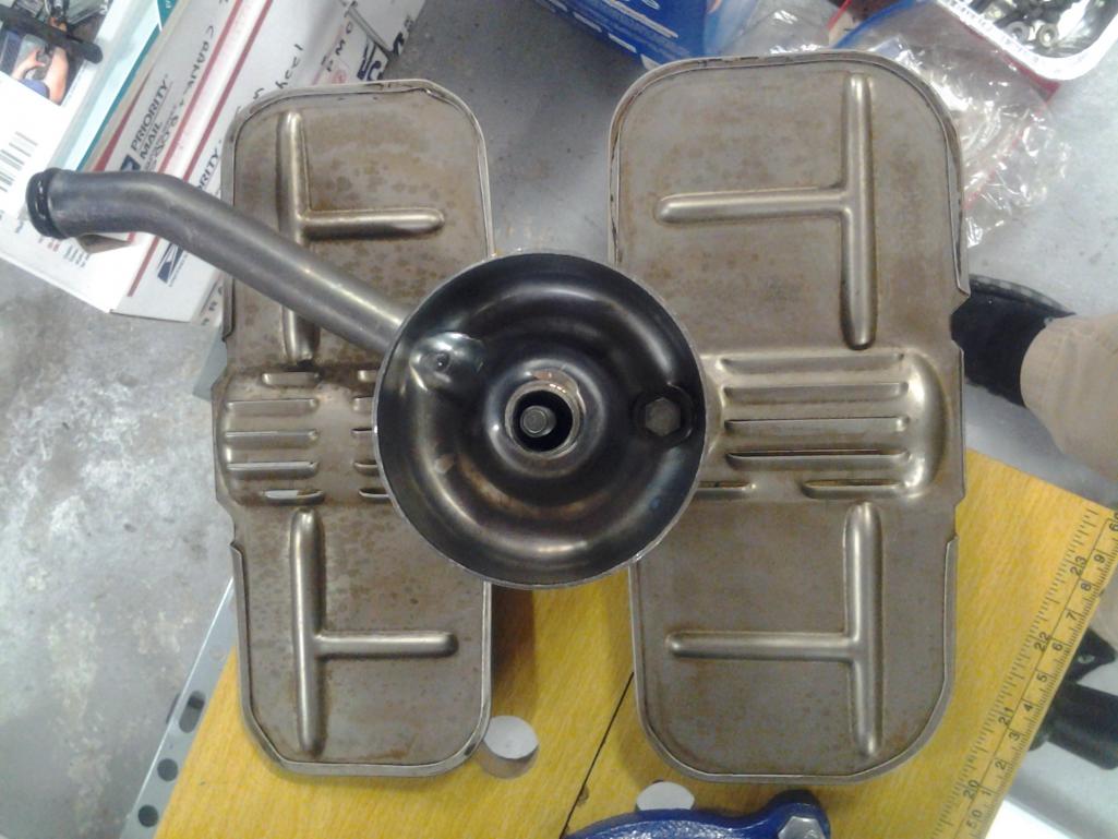

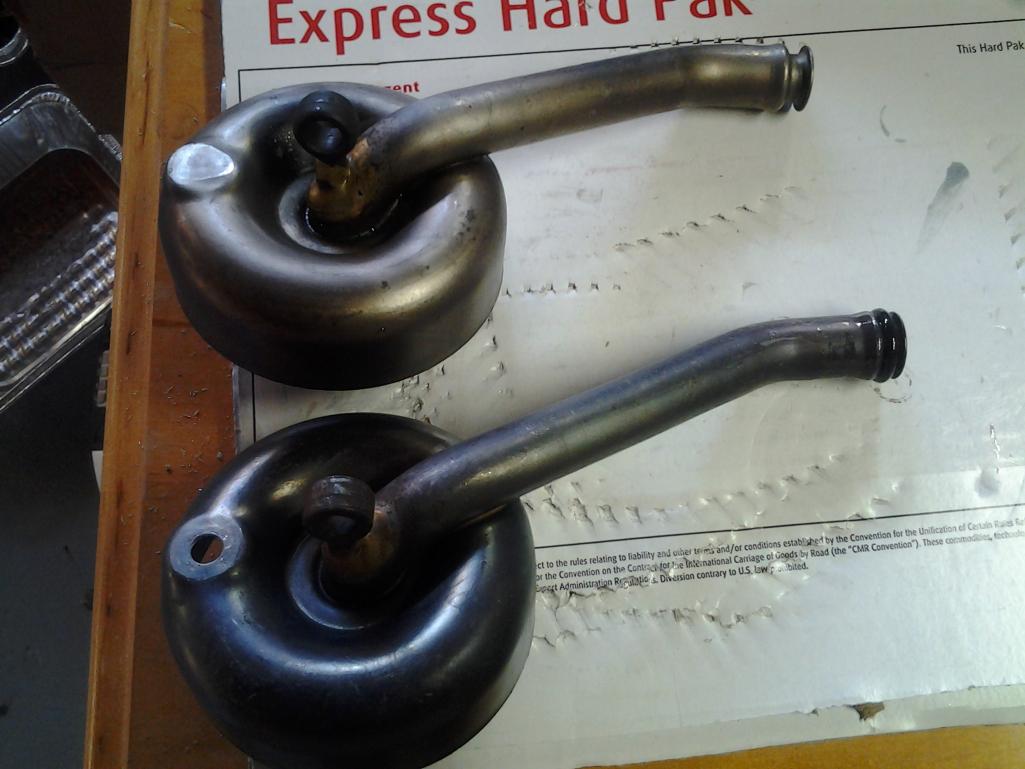

Windage/Baffle Plate
My core engine came without a windage plate so I sourced a good used one with its own oil pickup tube. It turned out to be very nice after a good cleaning.
I replaced the o-ring on the tube, oiled it a bit and tried to fit it into the case. No matter how hard I tried, the tube didn't go in all the way. I started to suspect that something is wrong and pulled it out to take a look.
Turns out that there are 2 different dimensions of pickup tubes, fitting different cases.
The tube that came in the case is above and the tube that came with the windage plate is below (note the hole in the cup for the bolt holding the plate)
After I noticed this, I drilled a hole in my old pickup tube to use it with the windage plate and fitted the tube in the case.
One more problem solved. (IMG:style_emoticons/default/piratenanner.gif)
