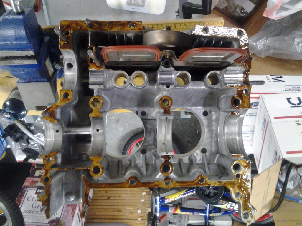

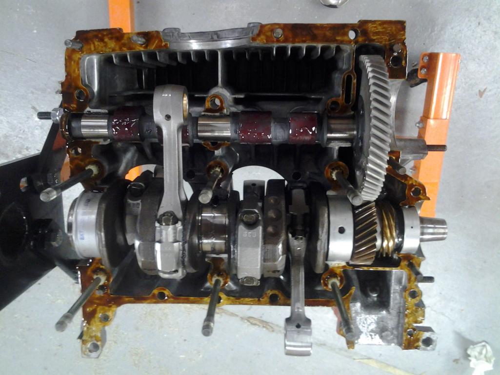

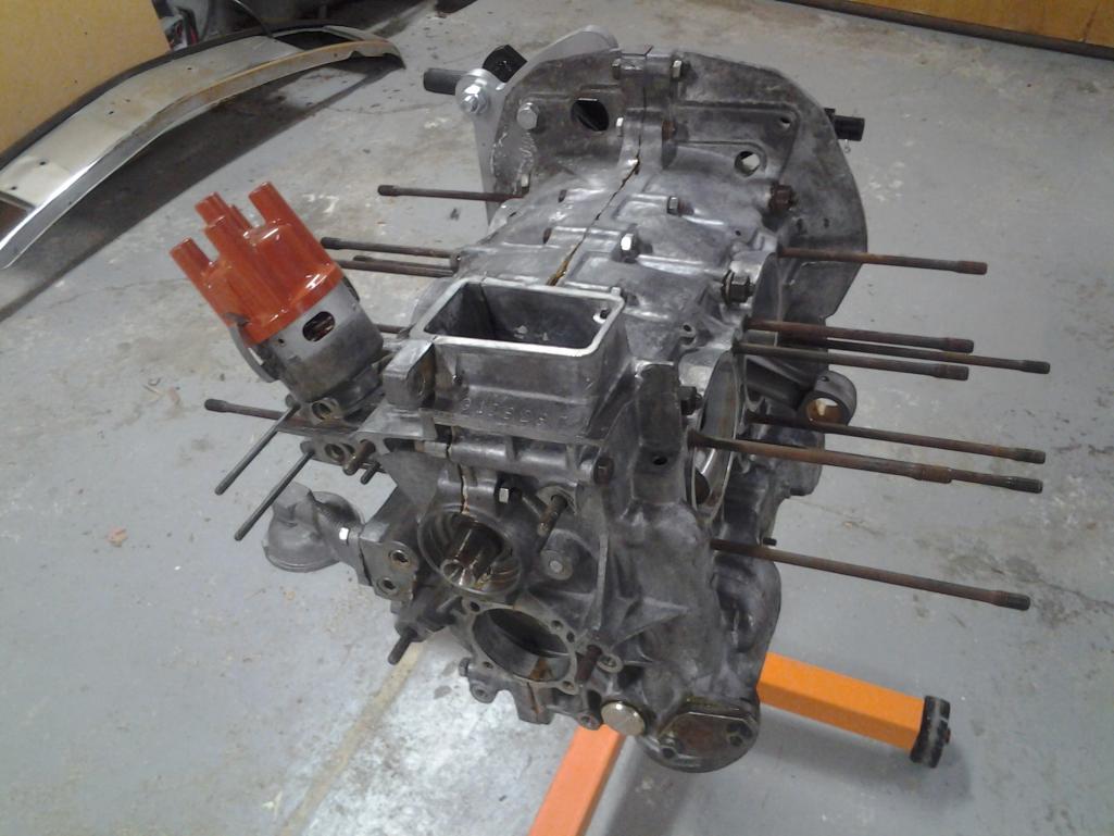

Closing the Case
With the windage plate, cam bearings and main bearing installed, I finally got to the stage where I can reunite the to case halfs!
I used sealer on the matting surfaces and around the big 6 bolts. I made sure all the passages to the bolt holes are sealed and also used sealant on the washers.
Then I closed the case and torqued all the bolts. There are 26 bolts: 6 big M10 ones, 18 M8 and 2 M6 at the oil breather.
