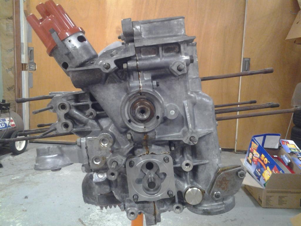

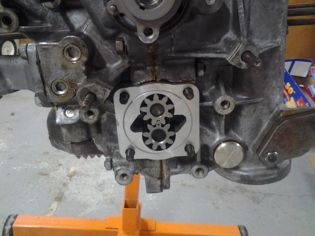

Type 1 Oil Pump Installation
I've been through the modifications I made to the Type 1 oil pump in a previous post.
The Type 1 oil pump is a bit thicker than the original type 4 pump. Therefore, the M8 studs that hold it in the case are a bit too short.
I almost replaced them but then I measured them and realized that I can just unscrew them a bit from the case and they will fit. The remaining length inside the case is sufficient to hold the pump (needs to be over 7 threads or 8.125mm since it's an aluminum case)
I fitted the pump case with the thick gasket I made and sealant, then I installed the driving gear and the idle gear and finally the cover with more sealant.
