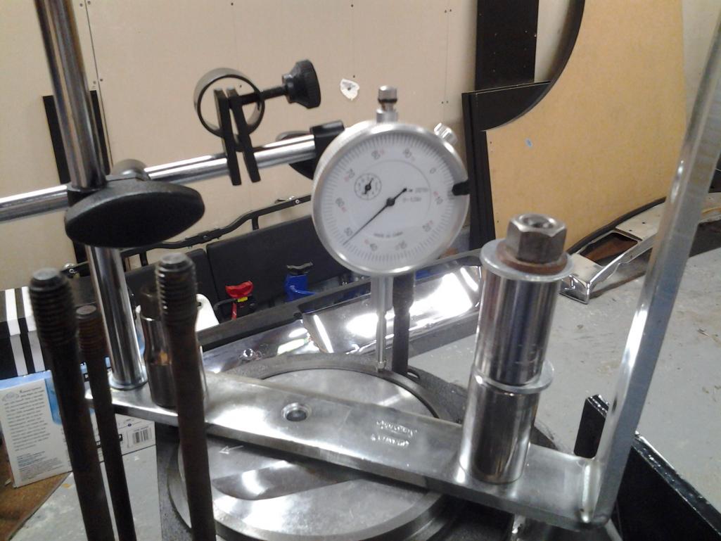

Deck Height
I set-up my dial meter to find TDC and to measure deck height.
After finding the TDC, I calibrated the dial meter on the piston and measured the cylinder height.
The picture shows my deck height of 0.048".
I also measured the valves recession into the piston --> 2.1cc (sorry, no picture)
