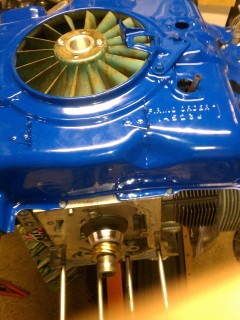

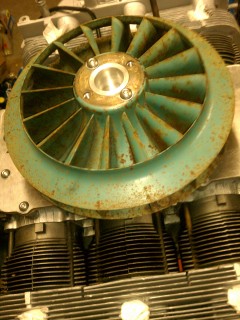

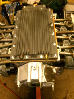

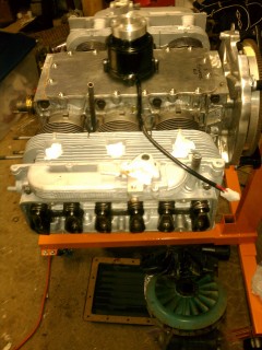

Been offline for a few months due to health issue. Was able to start working on it the beging of this month. Got engine just about ready to be put in the car, Hopefully will be ready by next weekend.
Balancer, dist, carbs, turbo, valve covers (haven't shown up yet) and clutch and in the car it goes.
