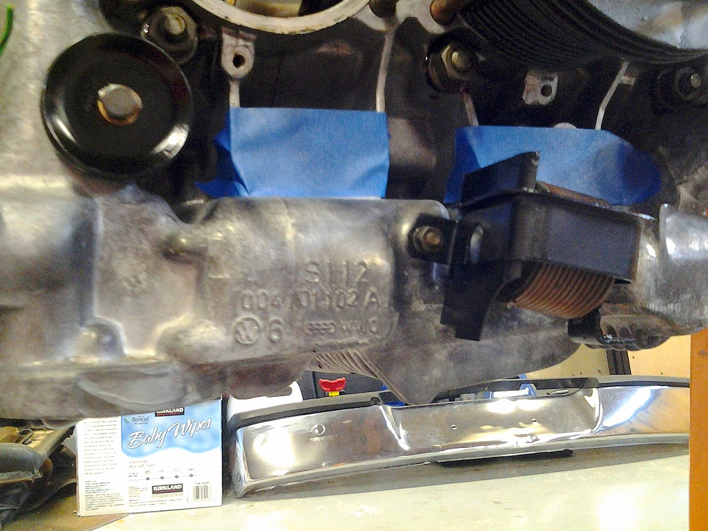

Thermostat
Slow progress this weekend as I was busy driving (IMG:style_emoticons/default/driving.gif)
I got good used thermostat but everything looked like hell. Bracket was rusted all over.
I cleaned and repainted the thermostat bracket and wheel.
