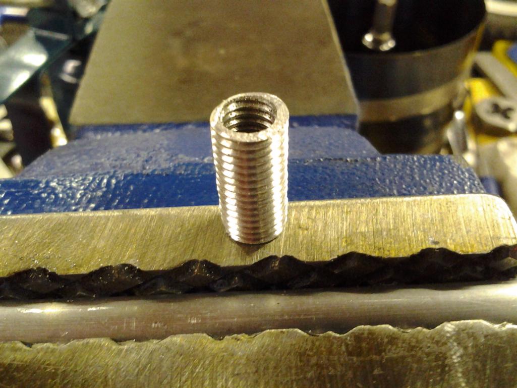

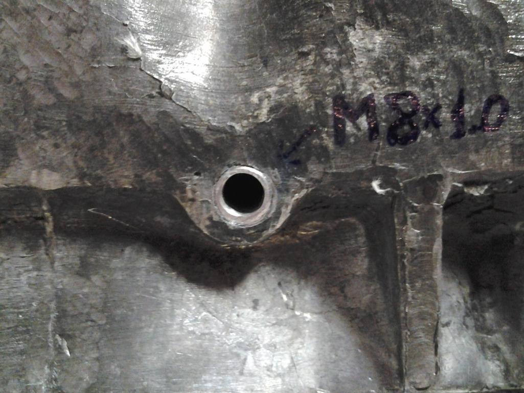

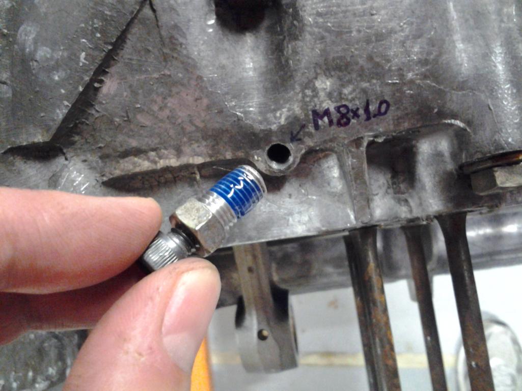

Fixing Broken a Tin Screw Hole
Some PO of this engine broke a tin screw in the block. I had been drilled out but I was left with a big hole and no screw to fit in it. I was able to tap the hole to M8x1.0 (fine thread) but being a bit too anal I had to go the extra mile and repair the original thread.
I took an 5/16 aluminum tube and threaded the outside to M8x1.0 and the inside to M6x1.0. After few tries, I got the threads synchronized for maximum strength.
Then I used my high-tech insertion tool (bolt and nut) to insert the insert with some thread lock into its hole.
And the result: that M8x1.0 turned into M6x1.0 (IMG:style_emoticons/default/piratenanner.gif)
