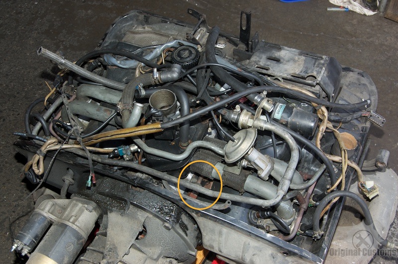

Here's a picture of the TTS in place on a 912E, but after thinking about it some more, I suspect this M8 x 1.00 hole (I checked another case here, and you're right) was on all engines that were destined for L-Jet.

Dave_Darling   That looks like it's near where the M8 hole is...   May 22 2012, 12:11 AM
Valy   That looks like it's near where the M8 hole i...   May 22 2012, 01:29 AM
McMark   Nope. Dave's right... About later cases. Early...   May 22 2012, 08:08 AM
Valy   Nope. Dave's right... About later cases. Earl...   May 22 2012, 09:28 AM
McMark   The thermo-time switch was moved towards the flywh...   May 22 2012, 09:48 AM
McMark   Here's a picture of the TTS in place on a 912E...   May 22 2012, 09:54 AM
Valy   Maybe it's a bus thing. I just double checked ...   May 22 2012, 10:25 AM
euro911   I've got a '75 GC case here that has the M...   May 22 2012, 11:16 AM
Valy   I'm not planning to take the insert out. The L...   May 22 2012, 12:03 PM
McMark   If you're running L-Jet, are you leaving off t...   May 22 2012, 12:04 PM
