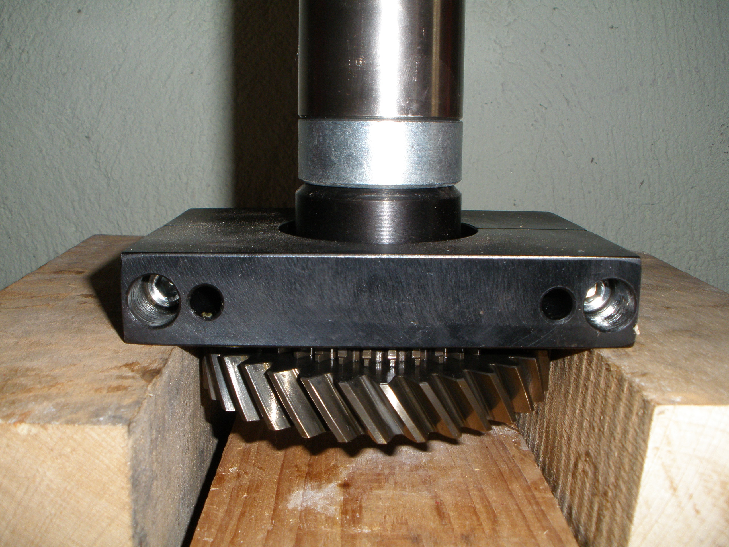

Next step of transmission rebuild, 1st gear dogteeth replacement and new synco ring. I used the special tool to remove the dogteeht ring and a shop press...without success. 4 up to 5 ton a big bang and a brocken ring
I got them off with a dremel whitout any grinding of the gear.

914Gelb   Next step of transmission rebuild, 1st gear dogtee...   May 23 2012, 01:21 PM

Dr Evil   Hey Georg, Great work. I have had only one ring b...   May 23 2012, 02:07 PM
Dr Evil   Did you need the smaller bearing that goes above t...   May 23 2012, 02:08 PM
Richard Casto   Georg, As Mike mentioned above, sometimes the rin...   May 23 2012, 02:56 PM
