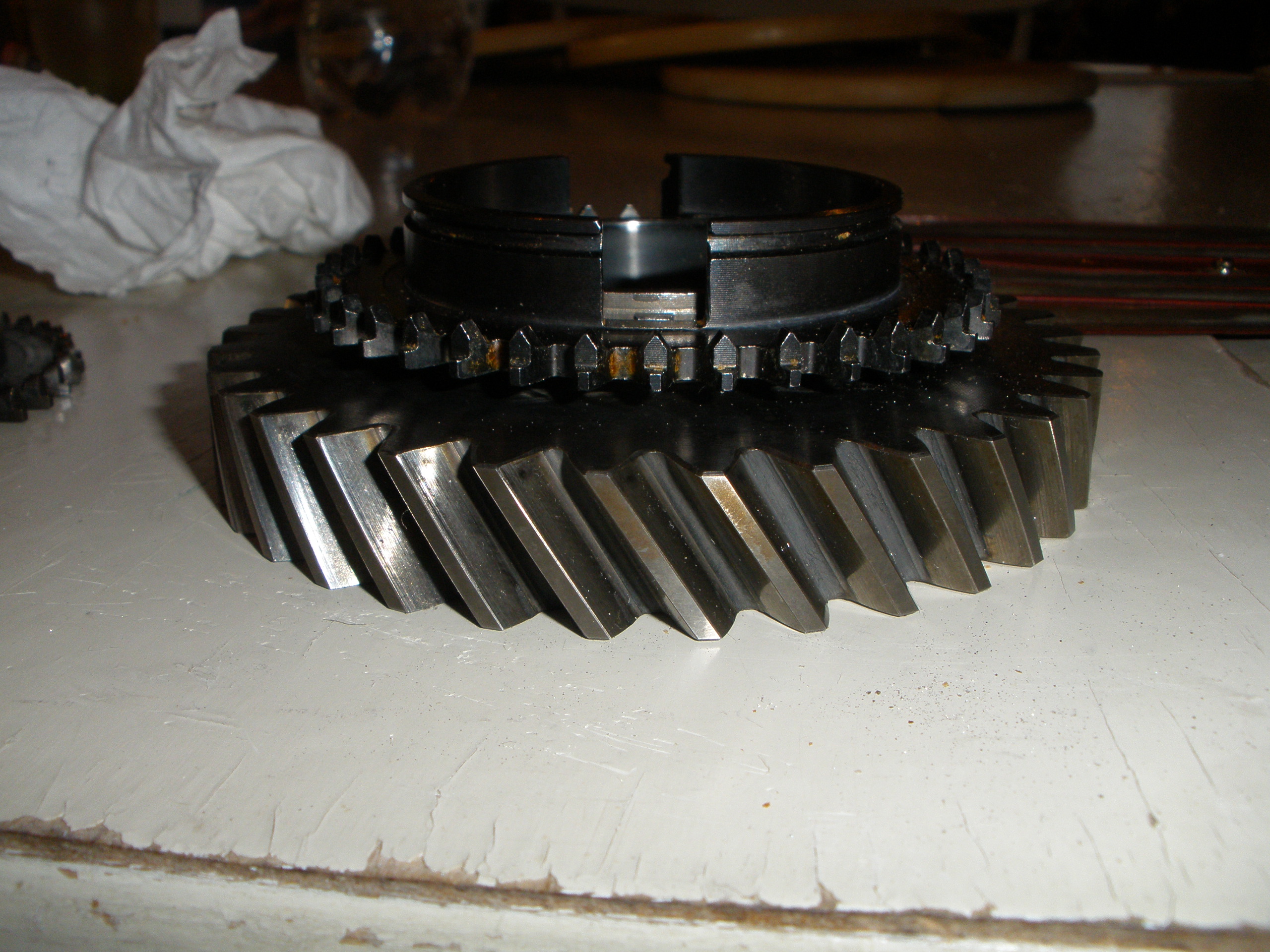

Hello guys,
I've bought my car without any test drive because it was unsed many years. Now my transmission is on my todo list. I already opened the case to inspect the 1st gear. I saw a syncro ring which seems to be less used but the dog teeth and the slider speeks other words. My impression.. I have to change slider, dog teeth and syncro. I added some pictures, who can distinguish between poo parts and reusable ones.

Next step installation of new dogteeht.

Dr Evil   Your slider looks fantastic. The gears show typica...   Feb 8 2012, 08:55 AM
Dr Evil   Oh, while you are in there, you should change out ...   Feb 8 2012, 08:56 AM
914Gelb   Oh, while you are in there, you should change out...   Feb 9 2012, 01:50 AM
jimkelly   no pic of a worn out slider but its the teeth, jus...   Feb 9 2012, 04:01 AM
914Gelb   I now know how new teeth should look like, but is ...   Feb 9 2012, 04:57 AM
Dr Evil   You can reuse teeth from other gears as long as yo...   Feb 9 2012, 12:39 PM
Dr Evil   As for wear limit, I do not know of an indicator. ...   Feb 9 2012, 12:41 PM

914Gelb   Hello, I measured the ring 72.00mm!   May 23 2012, 01:03 PM
914Gelb   Next step of transmission rebuild, 1st gear dogtee...   May 23 2012, 01:21 PM
914Gelb   Next step installation of new dogteeht.   May 23 2012, 01:35 PM
914Gelb   Last step the check according the manual. Perfect....   May 23 2012, 01:45 PM
