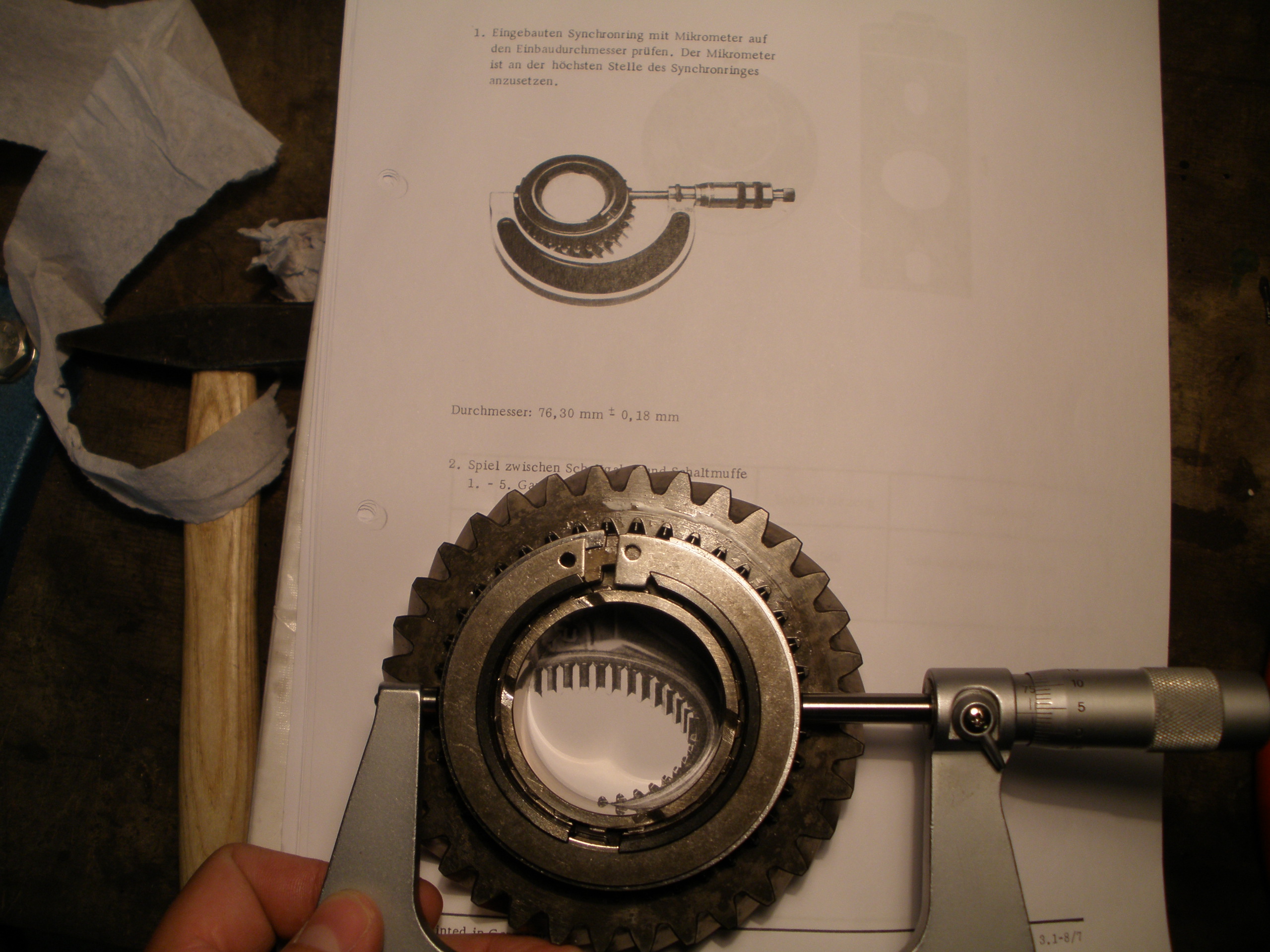

Hello guys,
I've bought my car without any test drive because it was unsed many years. Now my transmission is on my todo list. I already opened the case to inspect the 1st gear. I saw a syncro ring which seems to be less used but the dog teeth and the slider speeks other words. My impression.. I have to change slider, dog teeth and syncro. I added some pictures, who can distinguish between poo parts and reusable ones.

Last step the check according the manual. Perfect.. fully in range.

914Gelb   Hello, I measured the ring 72.00mm!   May 23 2012, 01:03 PM
914Gelb   Next step of transmission rebuild, 1st gear dogtee...   May 23 2012, 01:21 PM
914Gelb   Next step installation of new dogteeht.   May 23 2012, 01:35 PM
914Gelb   Last step the check according the manual. Perfect....   May 23 2012, 01:45 PM
