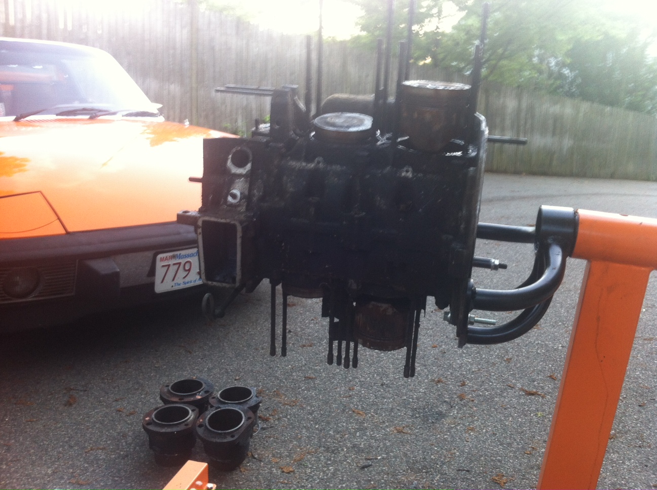

So with some less-than-gentle persuasion with a rubber mallet, I got the heads off my 1.7 core.
This engine didn't turn over and it's obvious why...the cylinders have rust on the inside and the pistons will not budge. I need to get the Ps and Cs off and I don't care if I damage them as they're toast anyway, but I need to keep the case pristine as this is what I'll be using for my rebuild (really it's why I bought the core).
So, any tricks to free up and remove the pistons and cylinders? More persuasion with a rubber mallet? Gallons of PB blaster? Mild explosive?

You are already trashing the pistons, get a hole saw and take out the top.....
Or, turn it on its side and fill each cylinder with coke....keep doing that till it will breake free.
Remember.....you really only need one side to come off....then you can unbolt the case and remove the rod bolts for the oTher side

the coke trick worked! (IMG:style_emoticons/default/smilie_pokal.gif)
Well, coke, plus whacking the living s$!t out of it with a piece of 2x4 and oak dowels, then using a big steel drift.
ONWARD!
