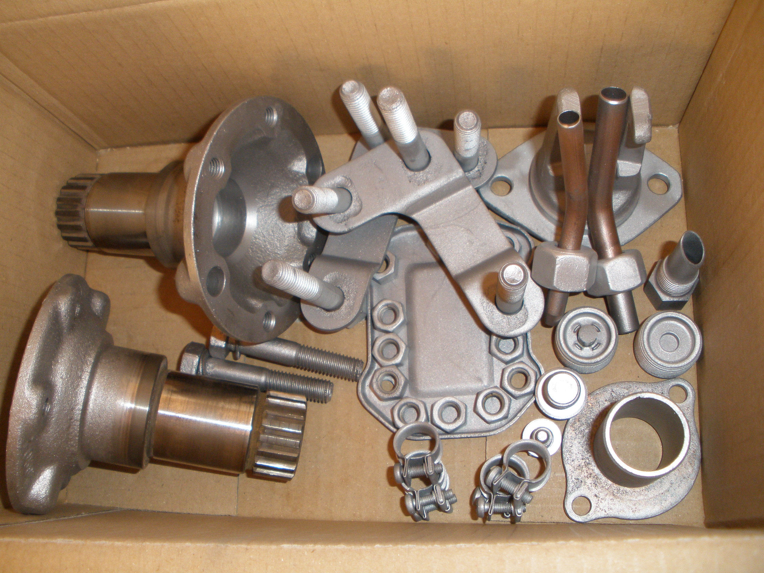

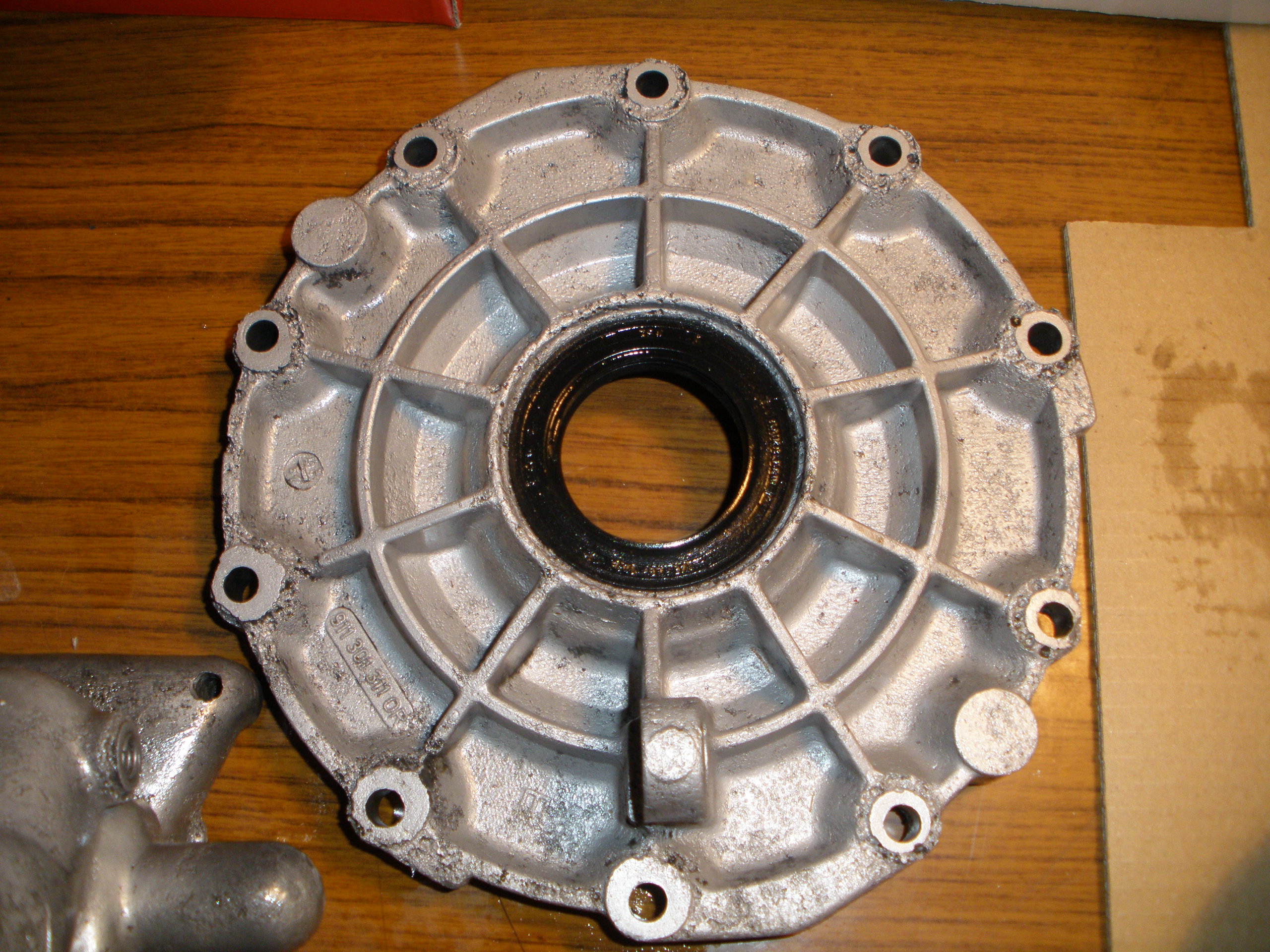

I continued my work with cleaning some parts of the transmission. Blasting oft parts which are later will be zink plated and case parst
I use WD40 to stop corusion of the magnesium case. If all is done and the case is closed after the rebuild I will use wax for that.
If I have the nissing Parts I will teardown the two shafts. I like to replace all syncros with new ones.
