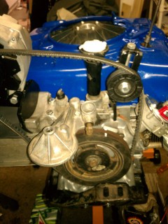

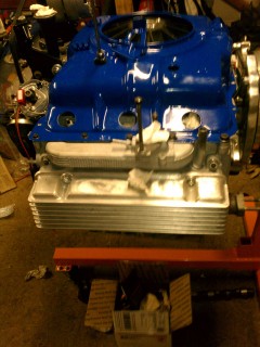

Ok engine is together minus turbo and carb's. (IMG:style_emoticons/default/piratenanner.gif) Will be coming off the stand tomorrow and clutch
and pressure plate going on. Attaching the transmission and getting ready for it to go in to the car.
Will take a bit to get it in as I will need to build Mount for it. Hopefully in a couple of weeks will be ready to start it up.
(IMG:http://www.914world.com/bbs2/uploads_offsite/i384.photobucket.com-9514-1339298617.1.jpg)
(IMG:http://www.914world.com/bbs2/uploads_offsite/i384.photobucket.com-9514-1339298617.2.jpg)
