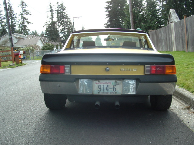

Did any of the early 6s that were not GTs ever have 2 in 2 out sport exhausts? If I am out of line (purists) with the muffler...just shut me down. I make nice 2 in 2 out sport exhausts for my 911s.
not from the factory, but many many have had that added.
Here is my dads from 1977 it has had a home made one. (i have the -6 still) And I have the big rear valance drilled for the sport pipe. (IMG:style_emoticons/default/blink.gif)
