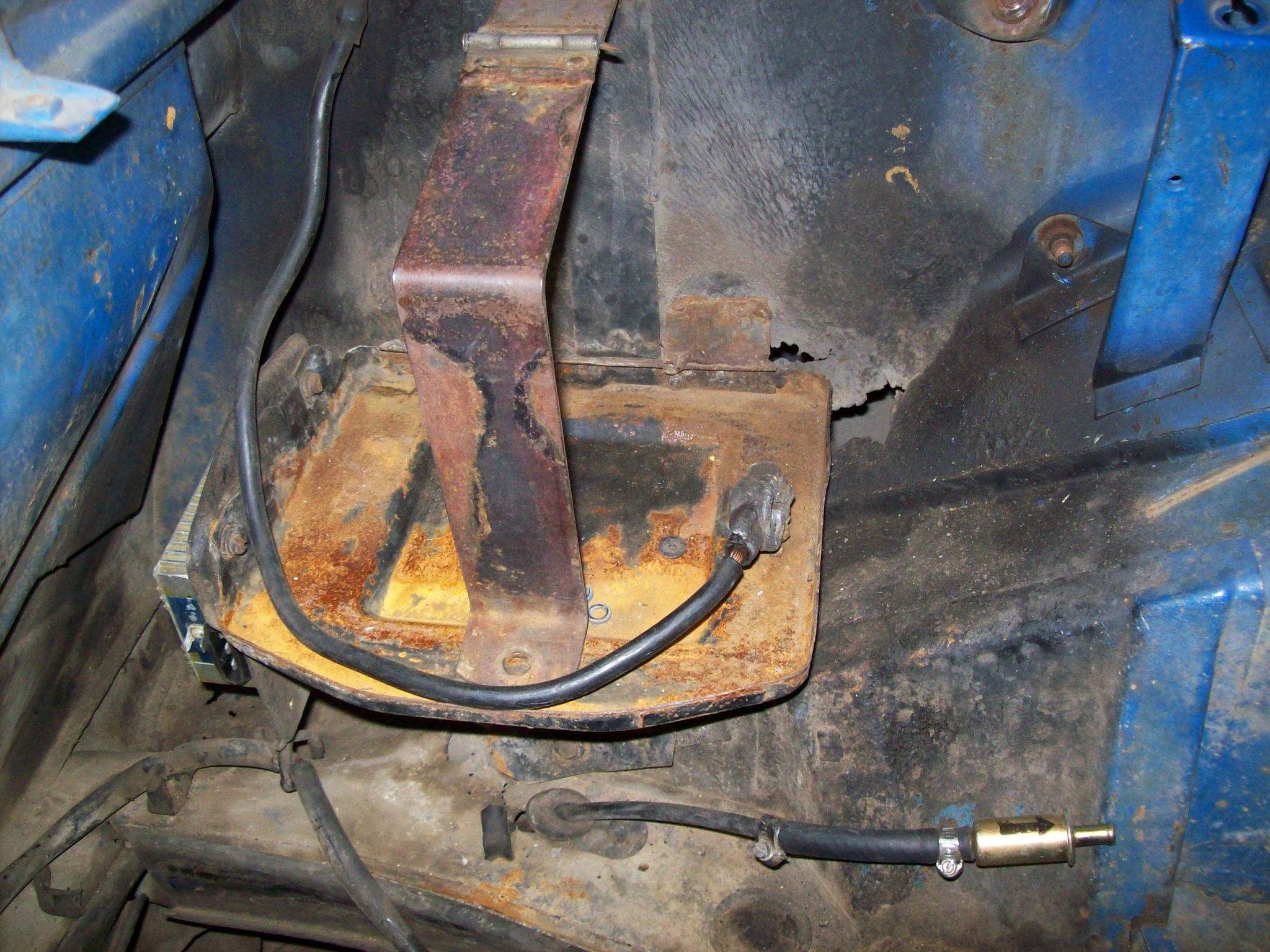

I took a few hours Friday afternoon,a couple yesterday, and a few more today. Almost ready for the blaster
yuck...passenger side. Drivers side looks ok. Before you question...yes I do have some hell-hole issues.

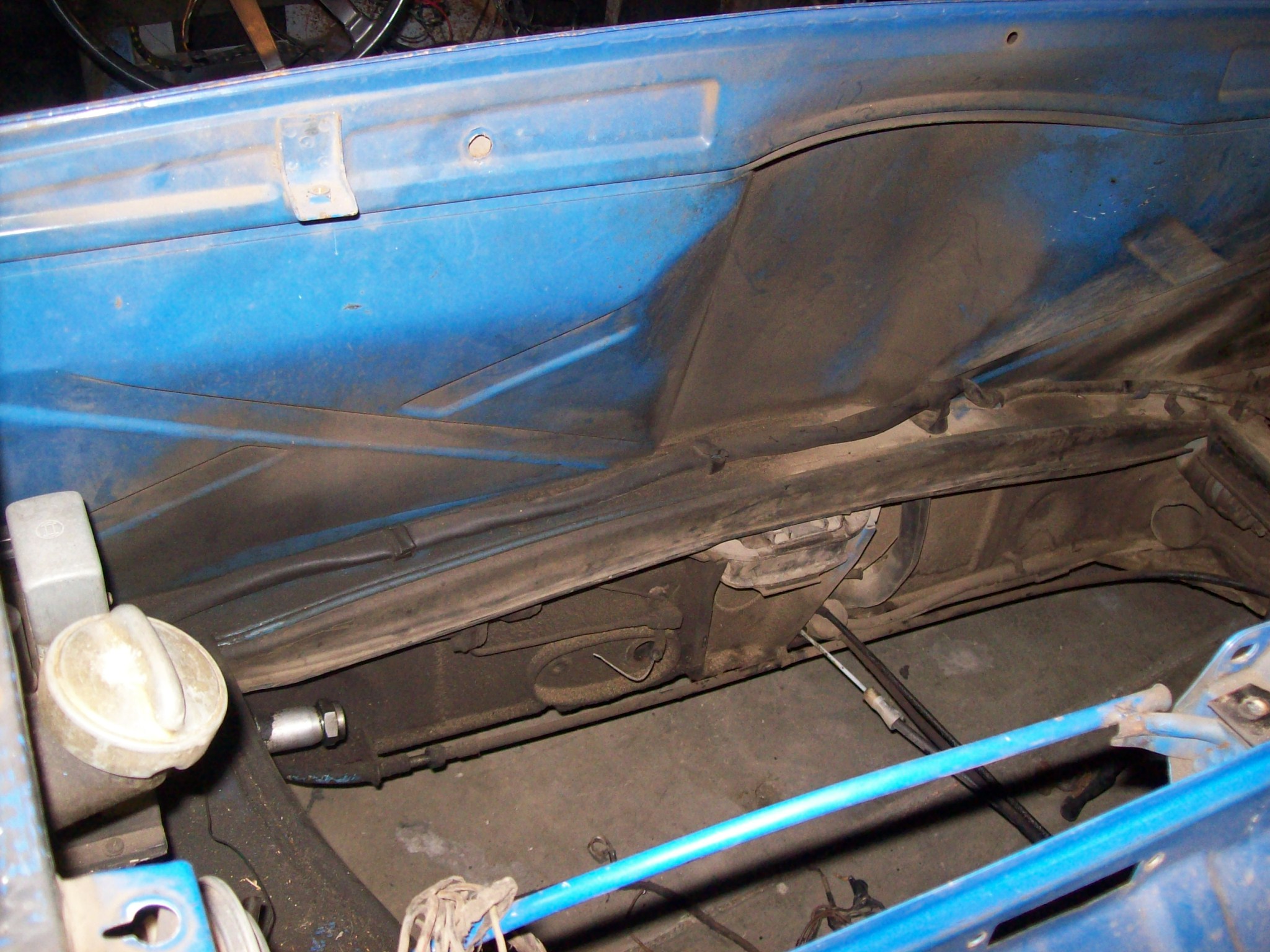

Couple more...the hell hole. Hopefully after blasting doesn't turn into the "hell holes" or the "never ending hell chasm".

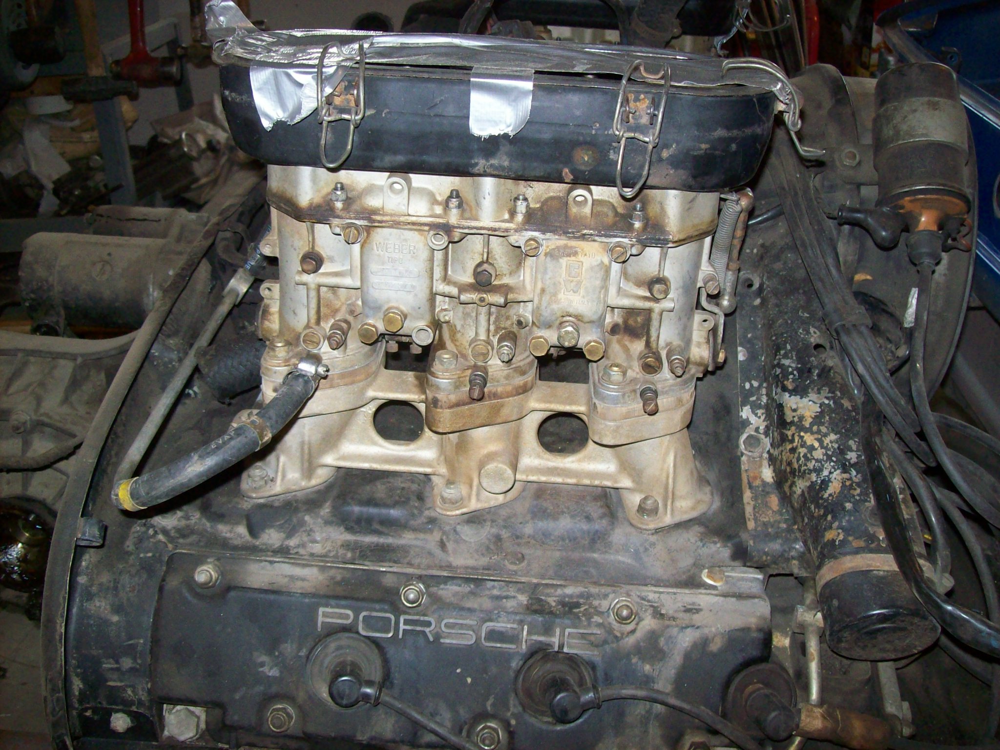

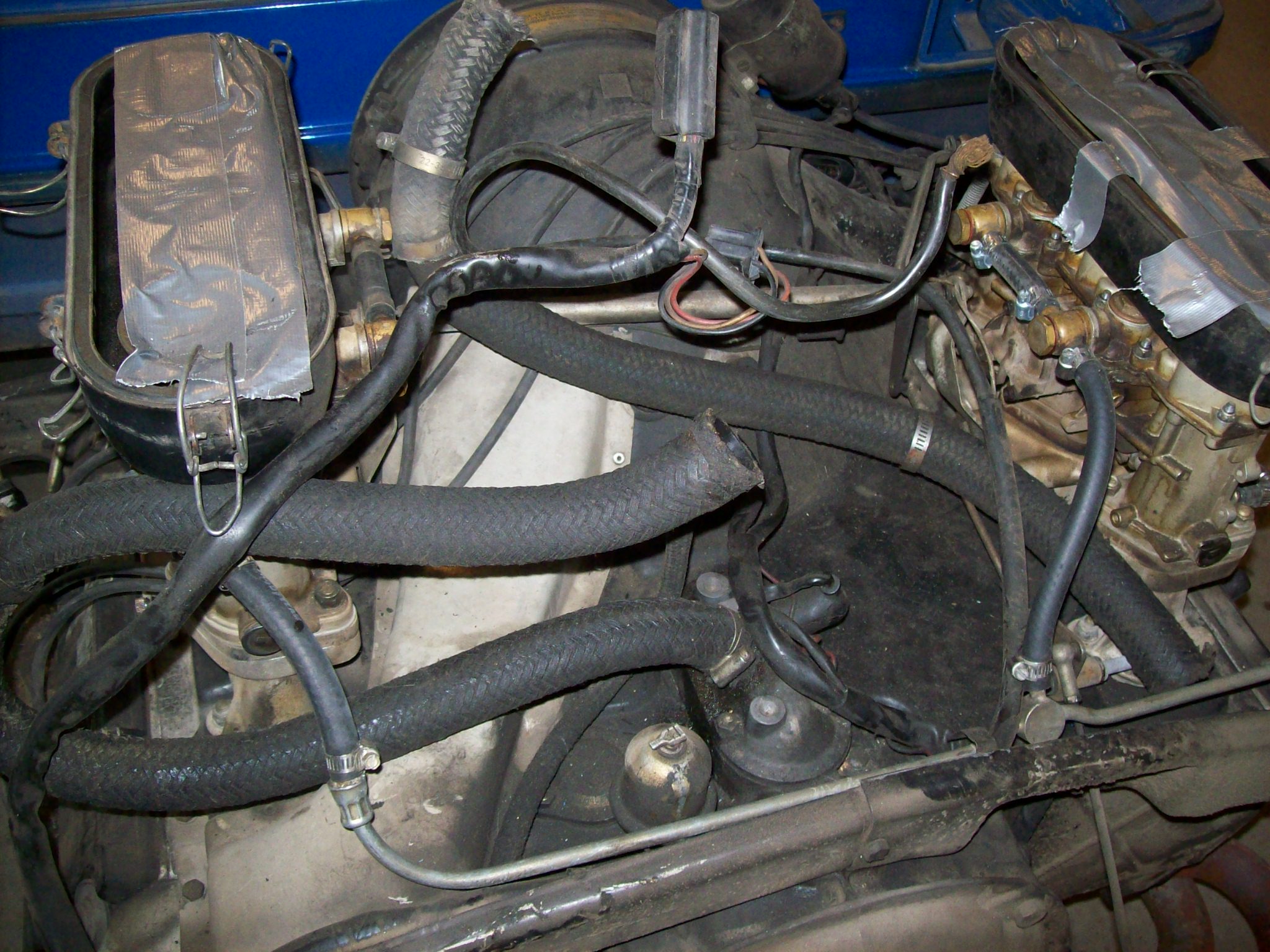

The PO ( or the shop the PO hired) took the induction off the 2.0 and bolted it onto the 2.7, there is nothing special here. In fact it really would benefit from being cleaned up.

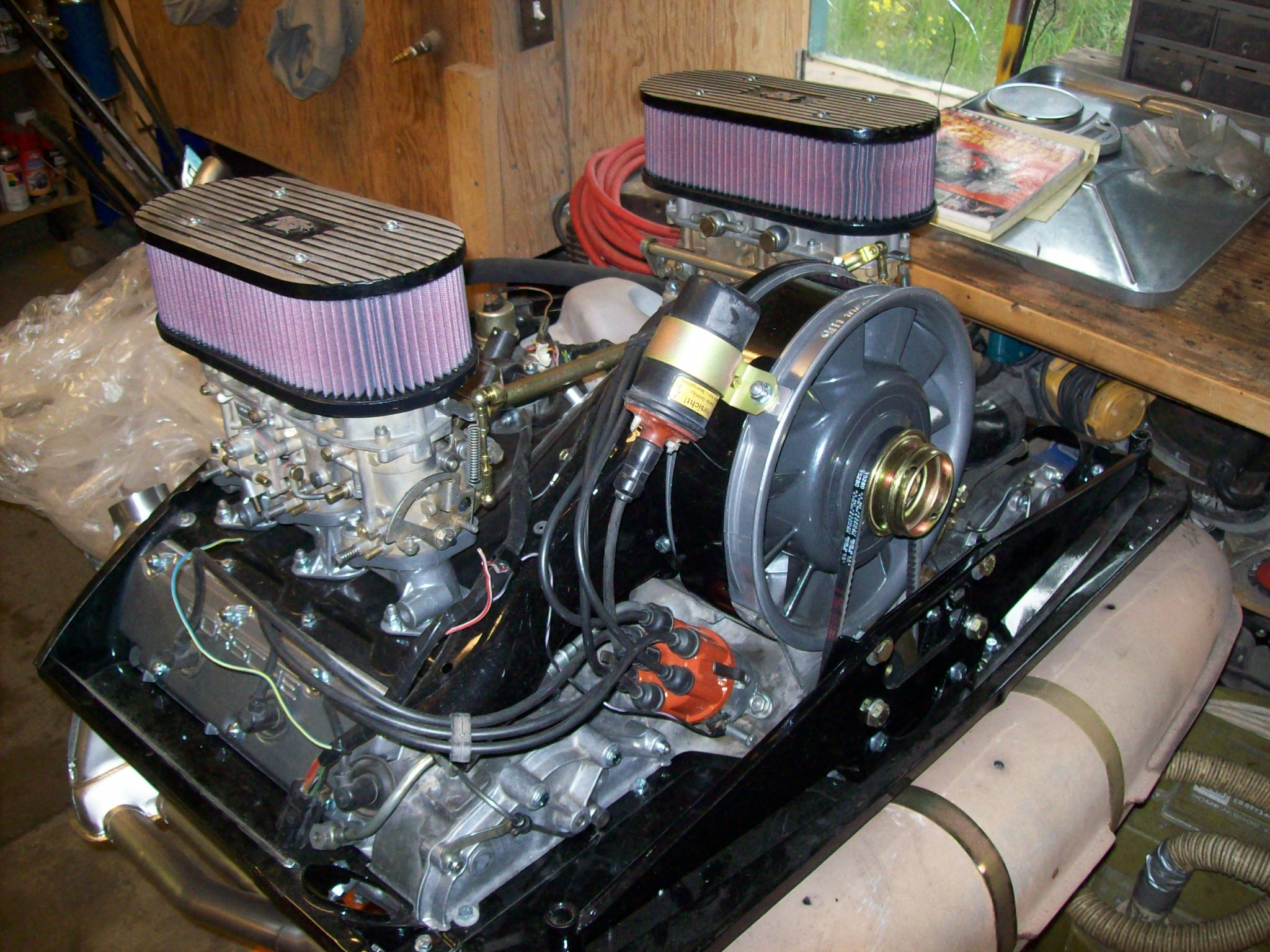

The 2.7 needs a makeover...here is the fresh stroked 2.2 w/ rebuilt Zeniths waiting for the 71 911 softie to come back from paint
I am going to ditch (store) the stock aircleaners and go with rainshields or K and Ns. In fact, it might make sense to put the stock induction (shroud, dizzie, fan and alt, carbs, air cleaner etc) back onto the 2.0 to keep it original, and run a good rebuilt set of 40 IDAs on the 2.7 with another shroud-dizzie etc.
