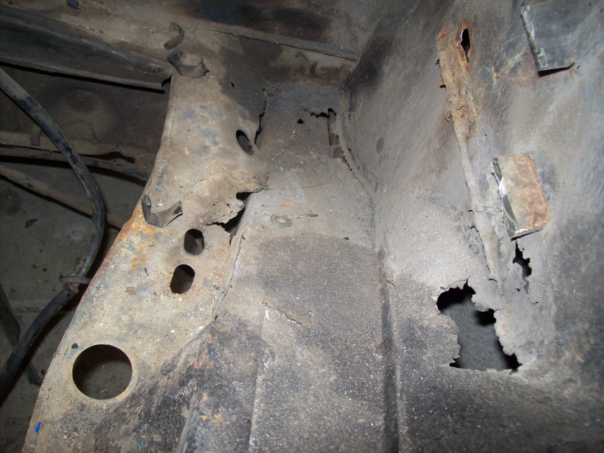

New to the board. Most of my work and experience is over on Pelican with 911 longhoods. I stalked a local PCA guy who was going to eventually sell his 914-6. No pressure, just every few months I let him know I hadn't forgotten. Finally got a chance to see the car in person three weeks ago. Passenger rocker issues as well as surface bubbling in a number of places. Car had been extensively autocrossed at PCA parades for years...very successfully. Owner had pulled the original 2.0 and replaced with a 2.7 RS spec engine with carbs. He bought another mid-engined car (boxster) and ignored the 6. I bought the car (w/ 2.7) and original engine. Got the 2.7 running well enough to drive the car...and decided to dive into the resto. I am familiar with rust, and plan to do it correctly. I have a rotisserie with 911 mounts, but shouldn't be a big deal to make mounts for the 6. Made a couple calls to Resto Design to check on parts...and away I go. I have a 71 911 softie that has been at paint too long...so while I wait for it to come home, thought I would see what my sandblasters schedule was. Turns out he can do the car in two weeks. So, I have a deadline. So...I guess this is my resto thread on my new Adriatic Blue 6...
I took a few hours Friday afternoon,a couple yesterday, and a few more today. Almost ready for the blaster

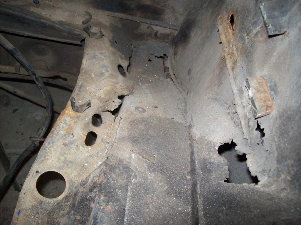

yuck...passenger side. Drivers side looks ok. Before you question...yes I do have some hell-hole issues.

pull that oil tank before it goes to the blaster...
you can't run the risk of anything contaminating it

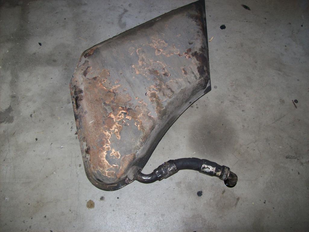

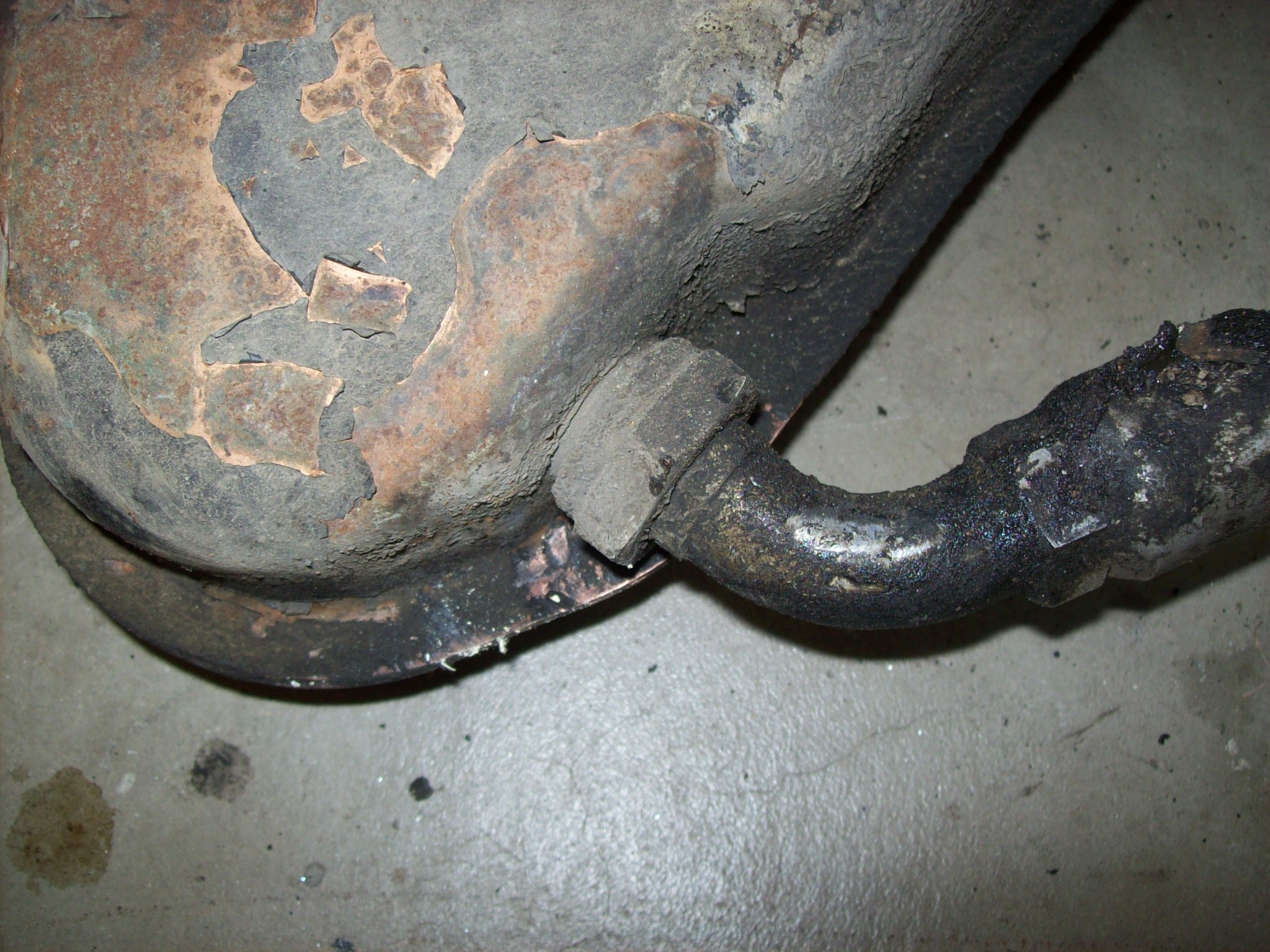

More prepping for sandblaster. Removing the oil tank...how come nobody warned me about this? What a mother! All the inside fittings were a piece of cake. The bottom oil line is close to impossible to get off while the oil tank is under the fender. I was going to dremel the line off, as it was the only thing prohibiting the tank from being removed...but I'd hate to find out after the fact that it was one of "those" lines that are beaucoup expensive. Impossible to get a wrench up in there to get the fitting off. I managed to get the thing out...
This was the culprit

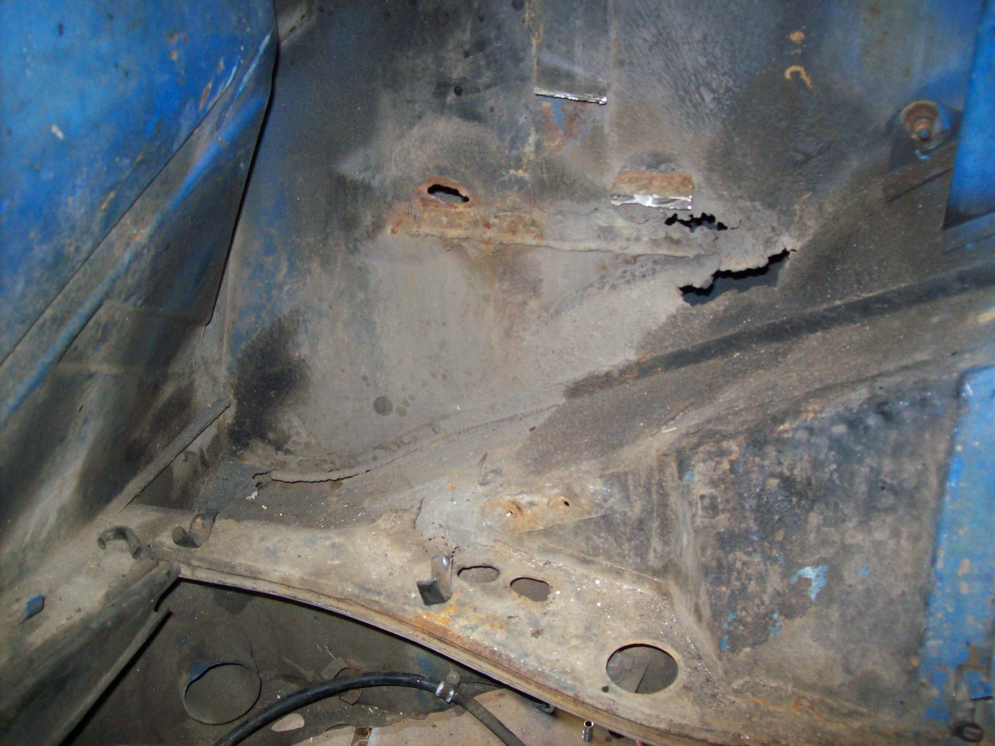

Gutted the rest of the engine compartment and found more not so great hell hole news...no big deal, I sort of expected it.

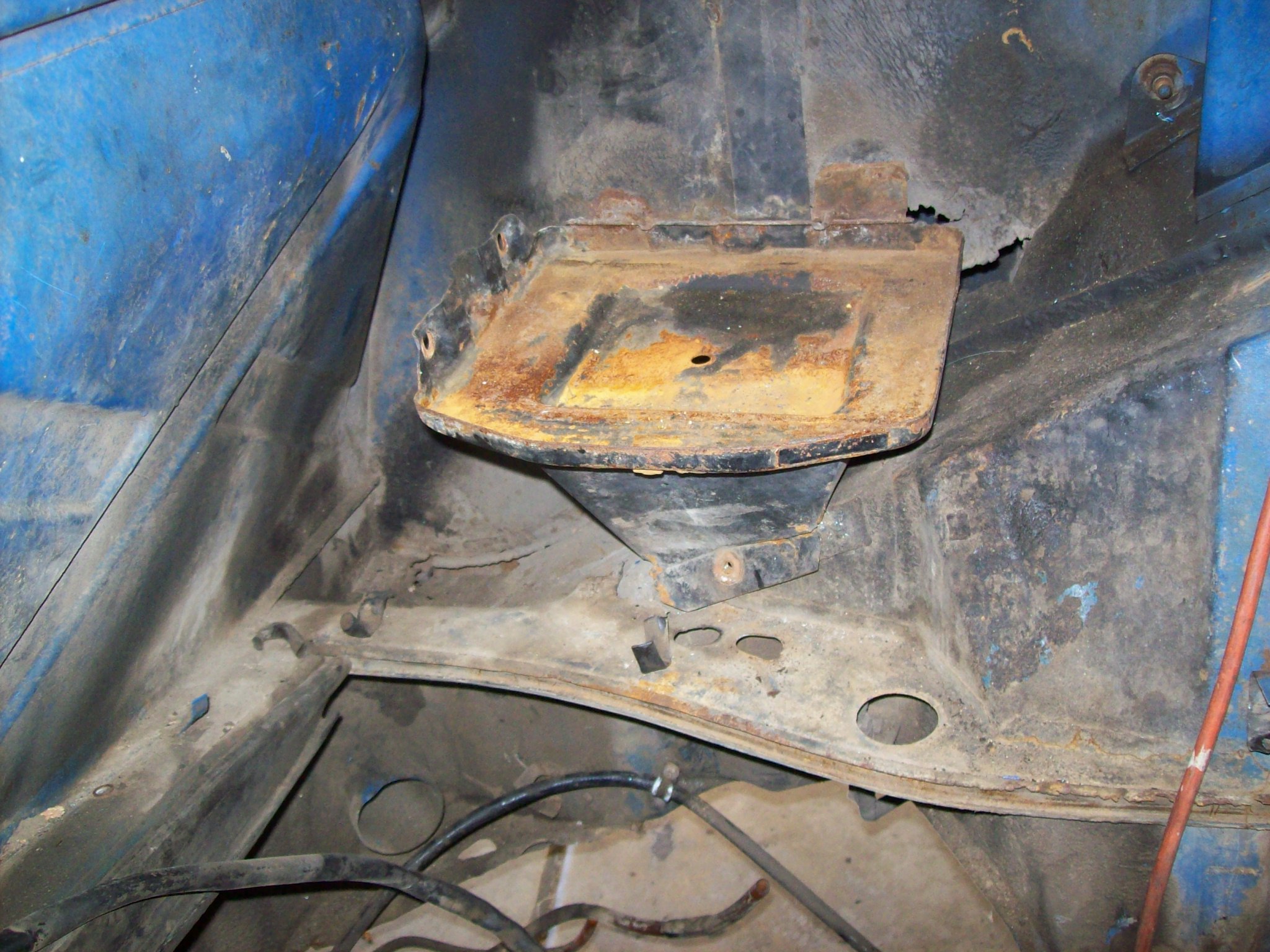

Ground out the old battery mount. It was actually factory steel, but a hack job of installation
