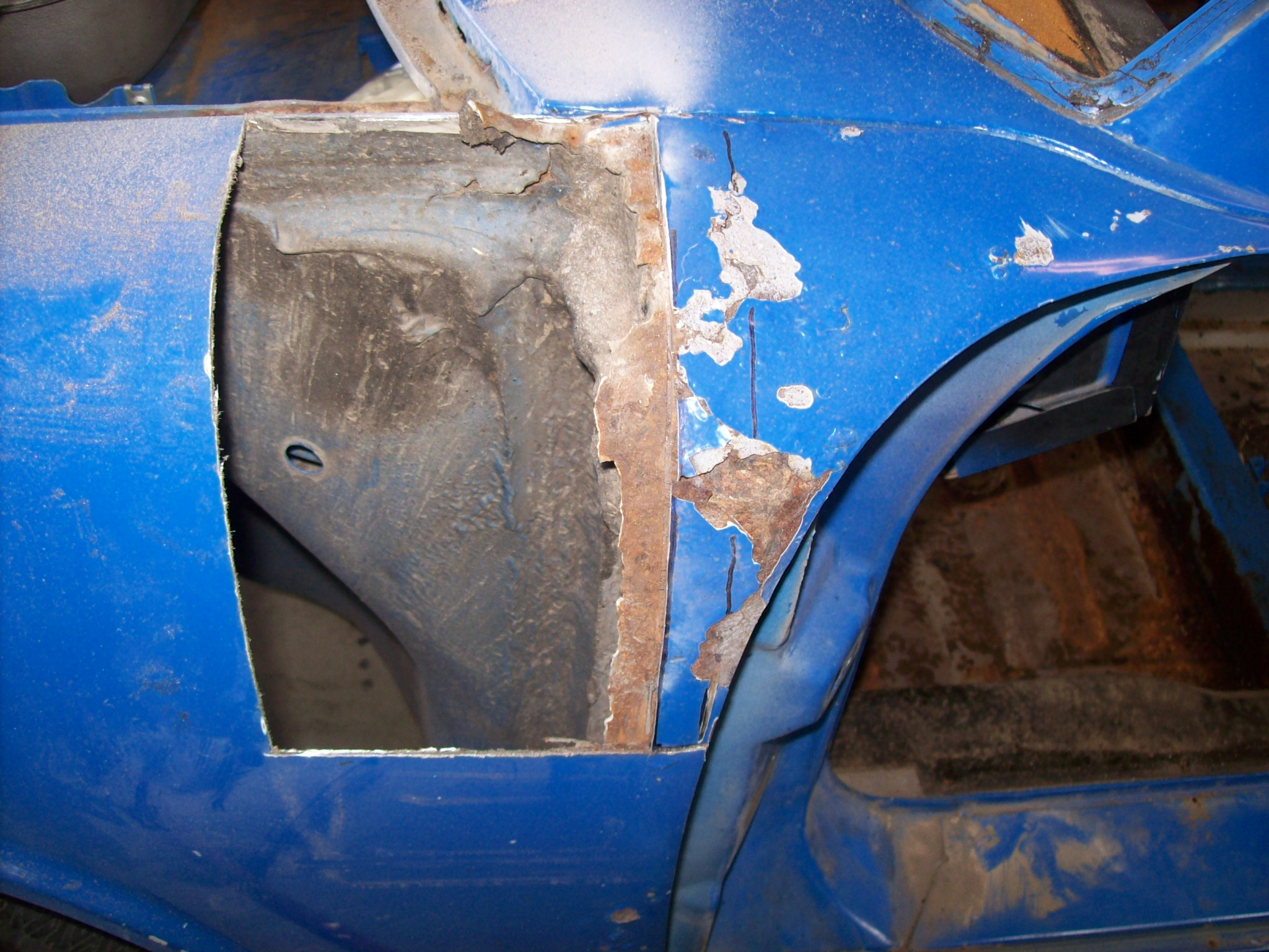

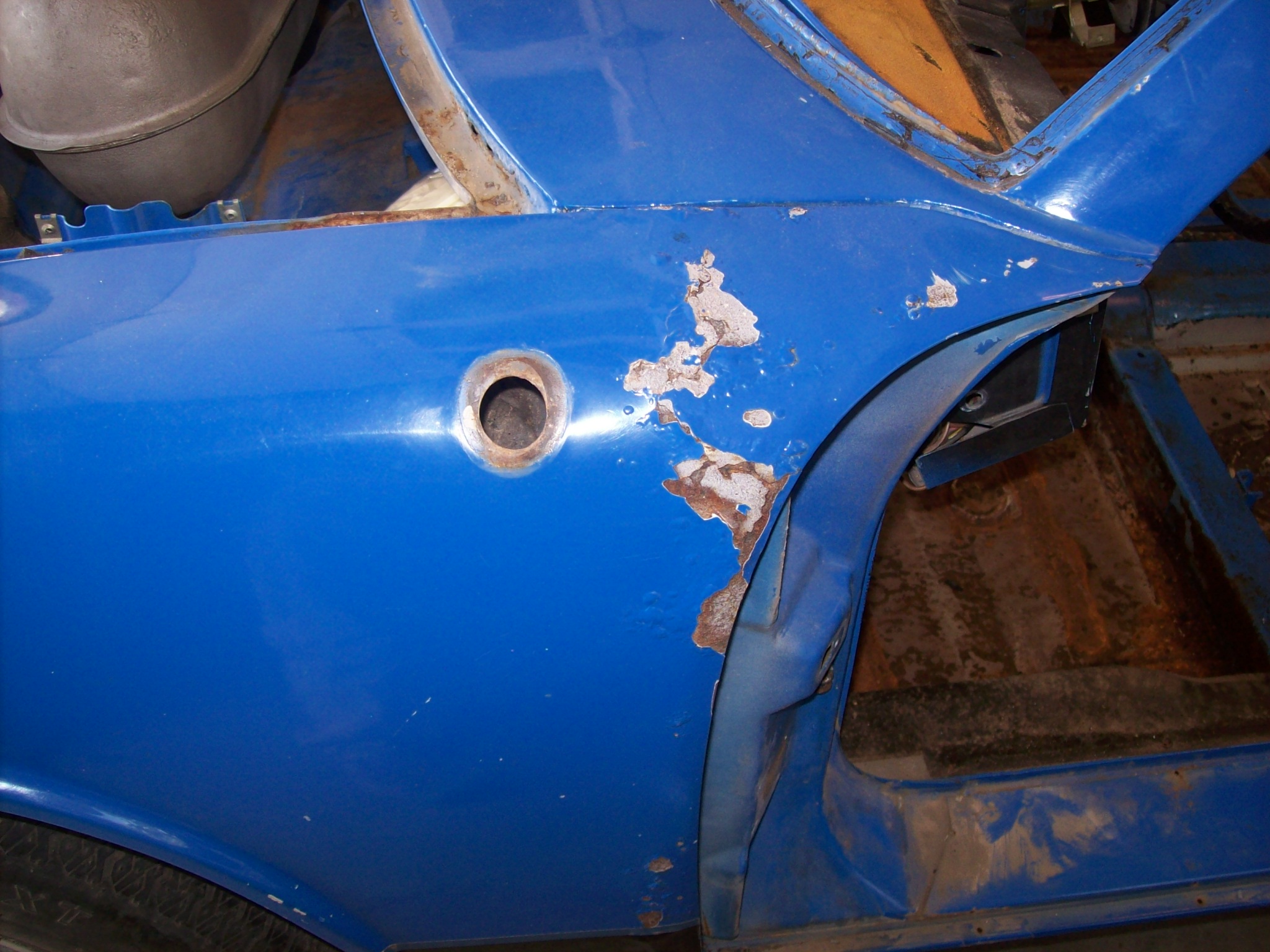

I took a few hours Friday afternoon,a couple yesterday, and a few more today. Almost ready for the blaster
yuck...passenger side. Drivers side looks ok. Before you question...yes I do have some hell-hole issues.

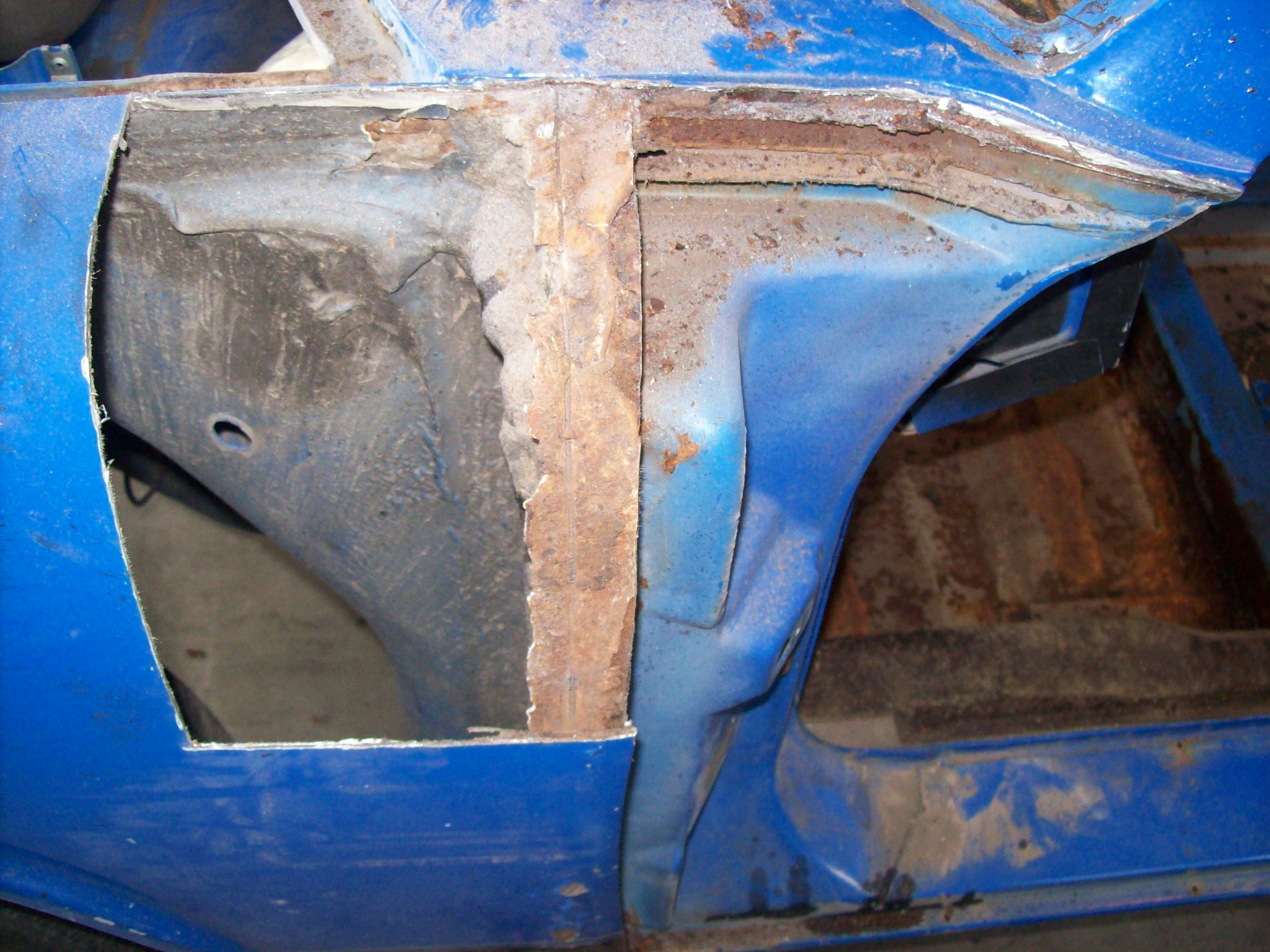

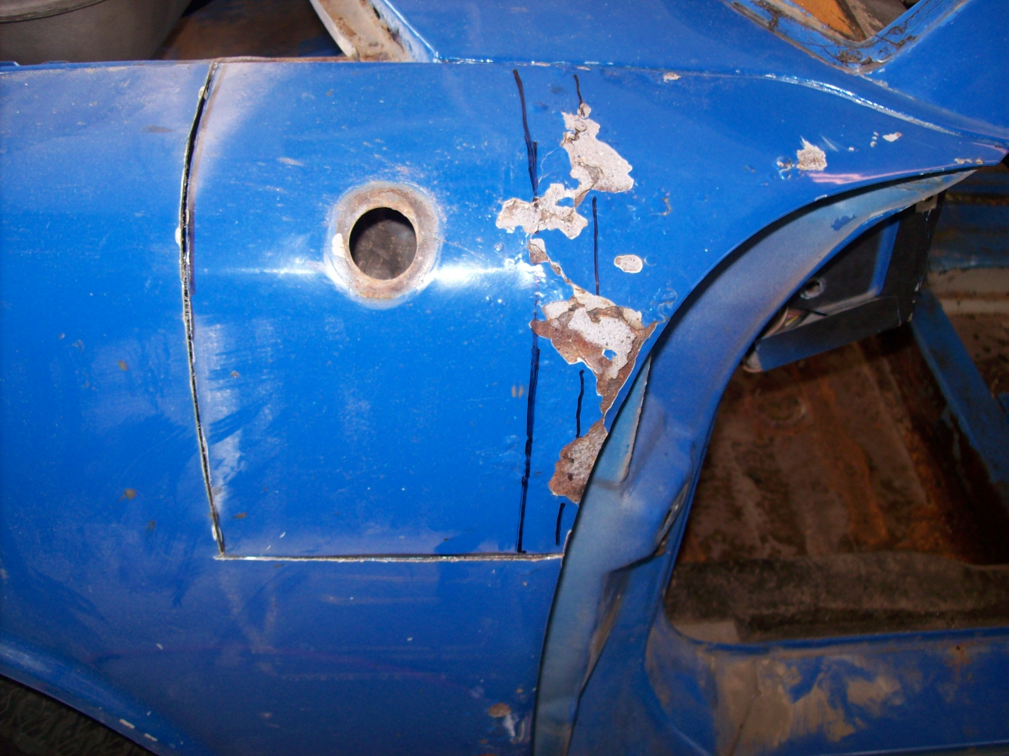

Marching orders...cut the bad out before the sandblaster. So I have two specific areas that are going to need to be very exposed to the media (not the paparazzi).
I need to cut back on the tail of the fender to clean up what is underneath....mark and cut
The damage is worse than was apparent from the first pic...but not so bad from here. We'll wait to see what things look like back from the blaster
