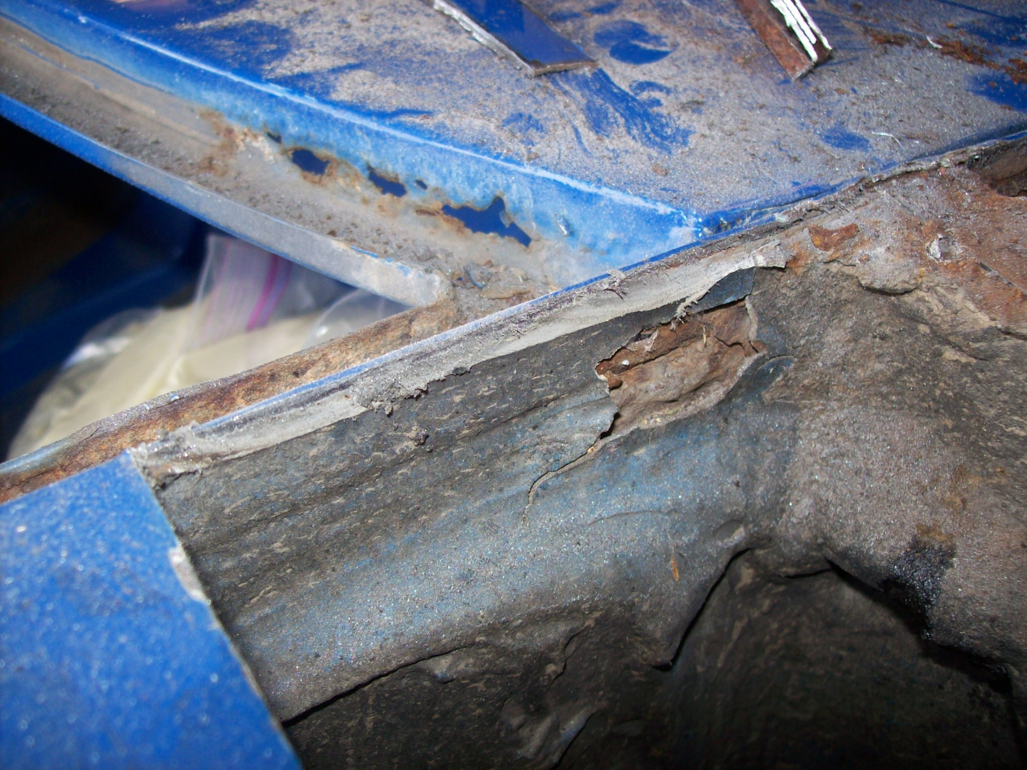

One more view of the perforations in the lip next to the bonnet

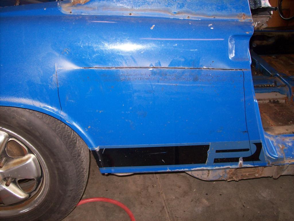

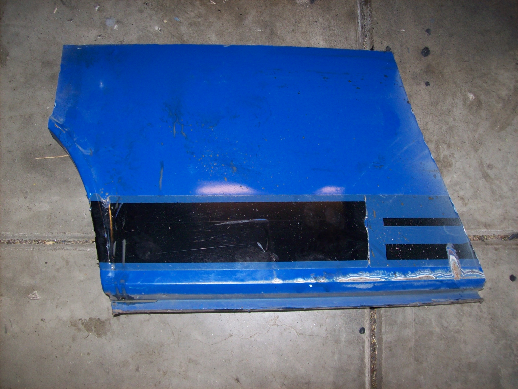

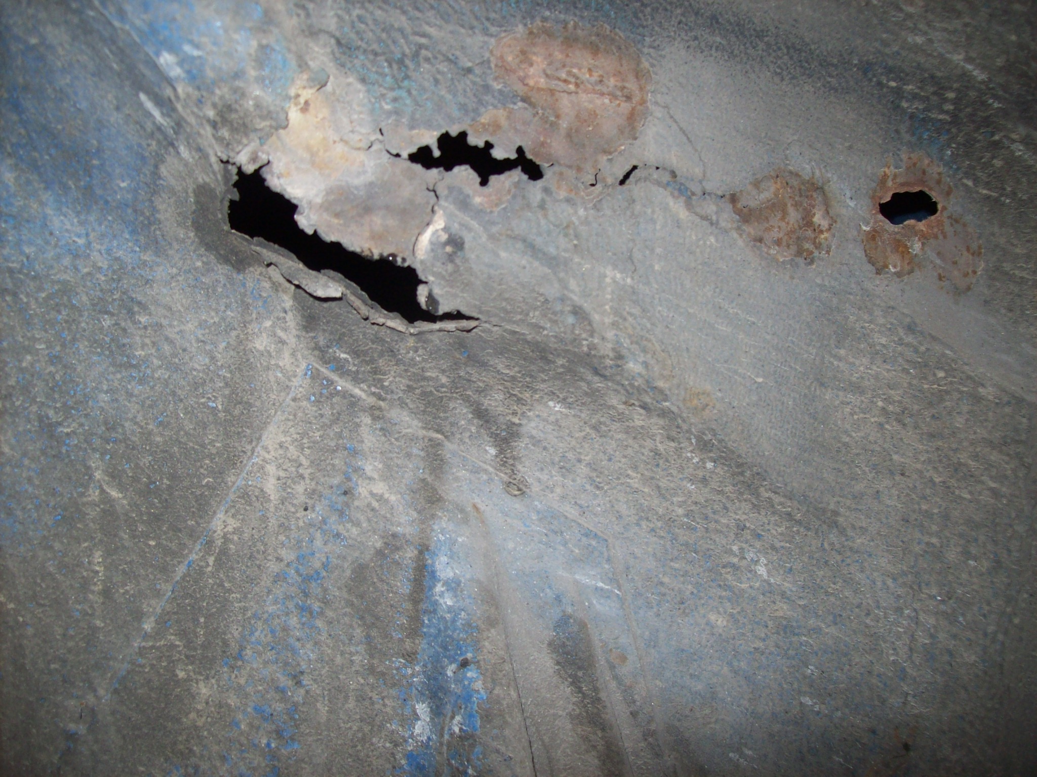

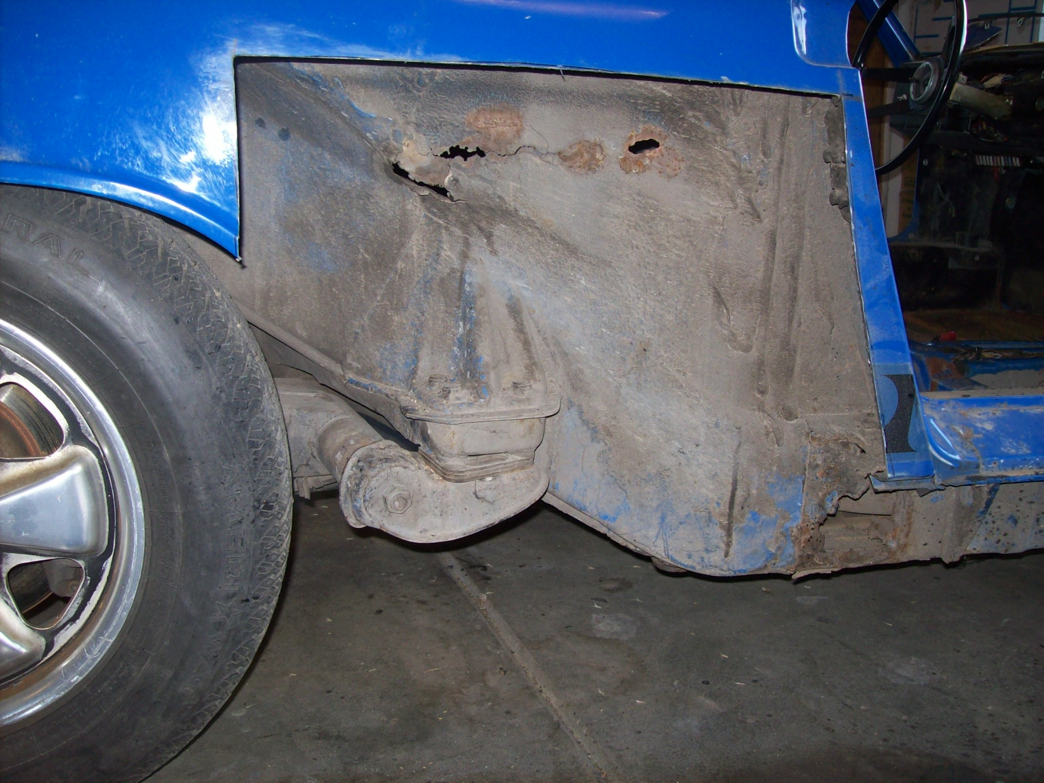

Now on to the quarter panel...that by the way is in decent shape. So yes, I am going to hack off a perfectly good quarter panel, just to gain access...and give the sandblaster access to the hell hole. First cut is the deepest...
What have I done???
This will get blasted better and more deeply. We'll get good access to the hell hole and inner fender.
