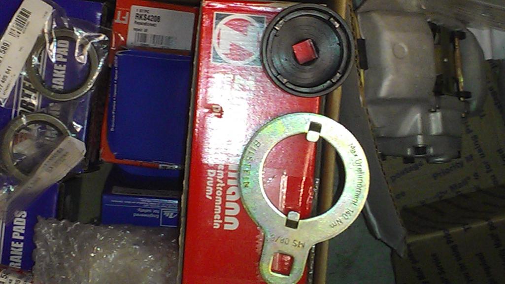

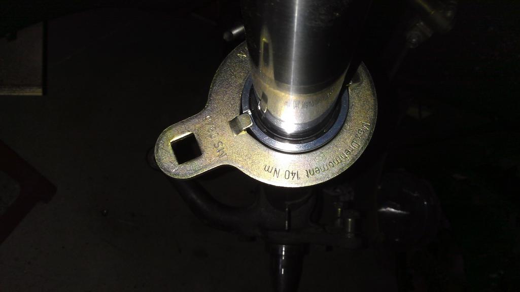

You can use a pipe wrench, vice, chisel and a hammer. It'll look like Chewbacca knawed on your fancy new parts. Or you can use the right tool for the job and make it look like someone who knew what they were doing installed the parts.
