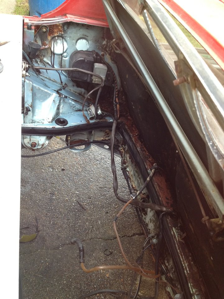

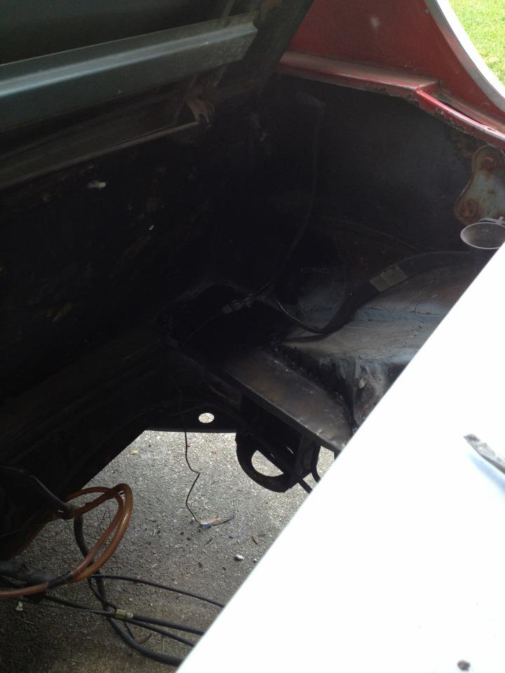

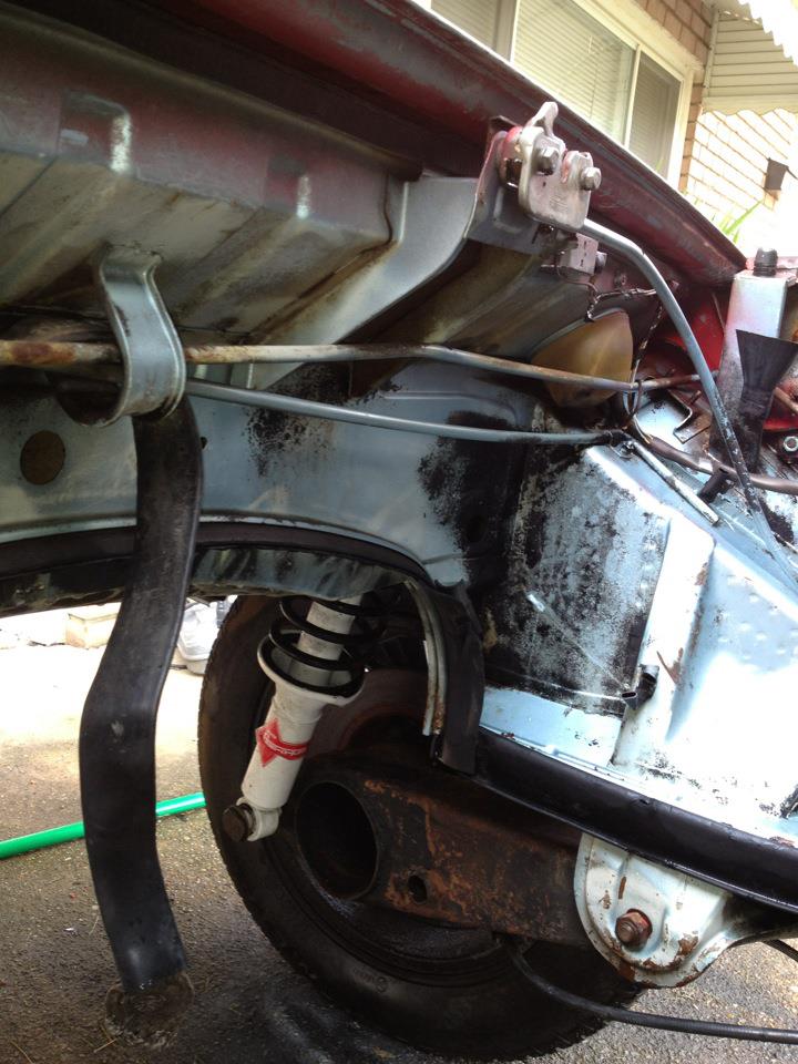

I finally got my car home the other night. Its been almost 2 years since I've gotten anything done. It seems like I have about a million things left to do so I figured i should pick somewhere to start. The engine bay seemed like a good place. I made up a new shelf to replace the one that rotted away and mounted the new battery tray support. Once I finished that up I soaked everything down with purple power and pressure washed it. I've decided to just paint the engine bay high gloss black so it will be easy to keep clean and will go with whatever color I decide to paint the car.
