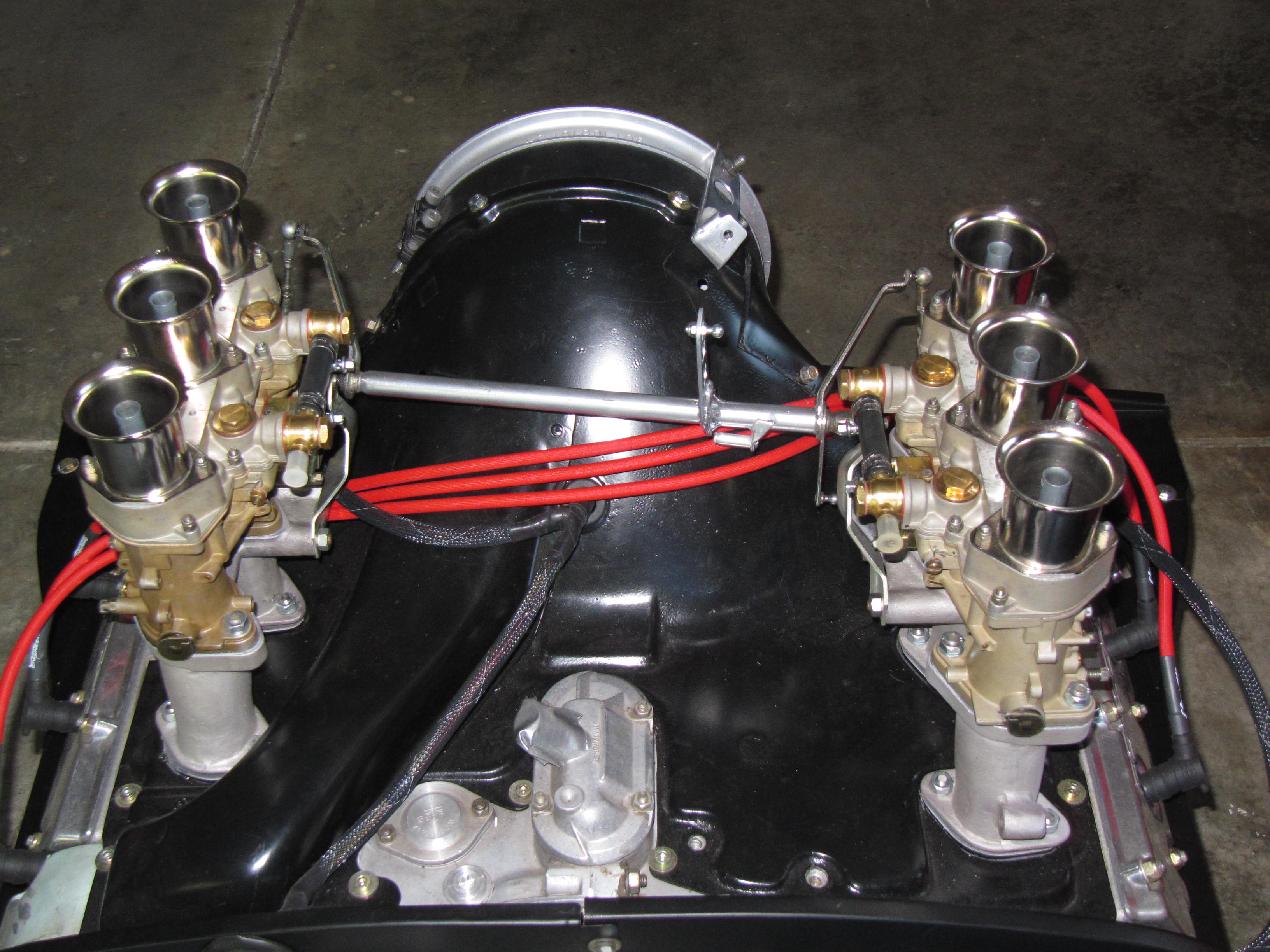

Krieger   Carbs done! I did the float bowel mod to keep...   Jun 24 2012, 12:27 PM
