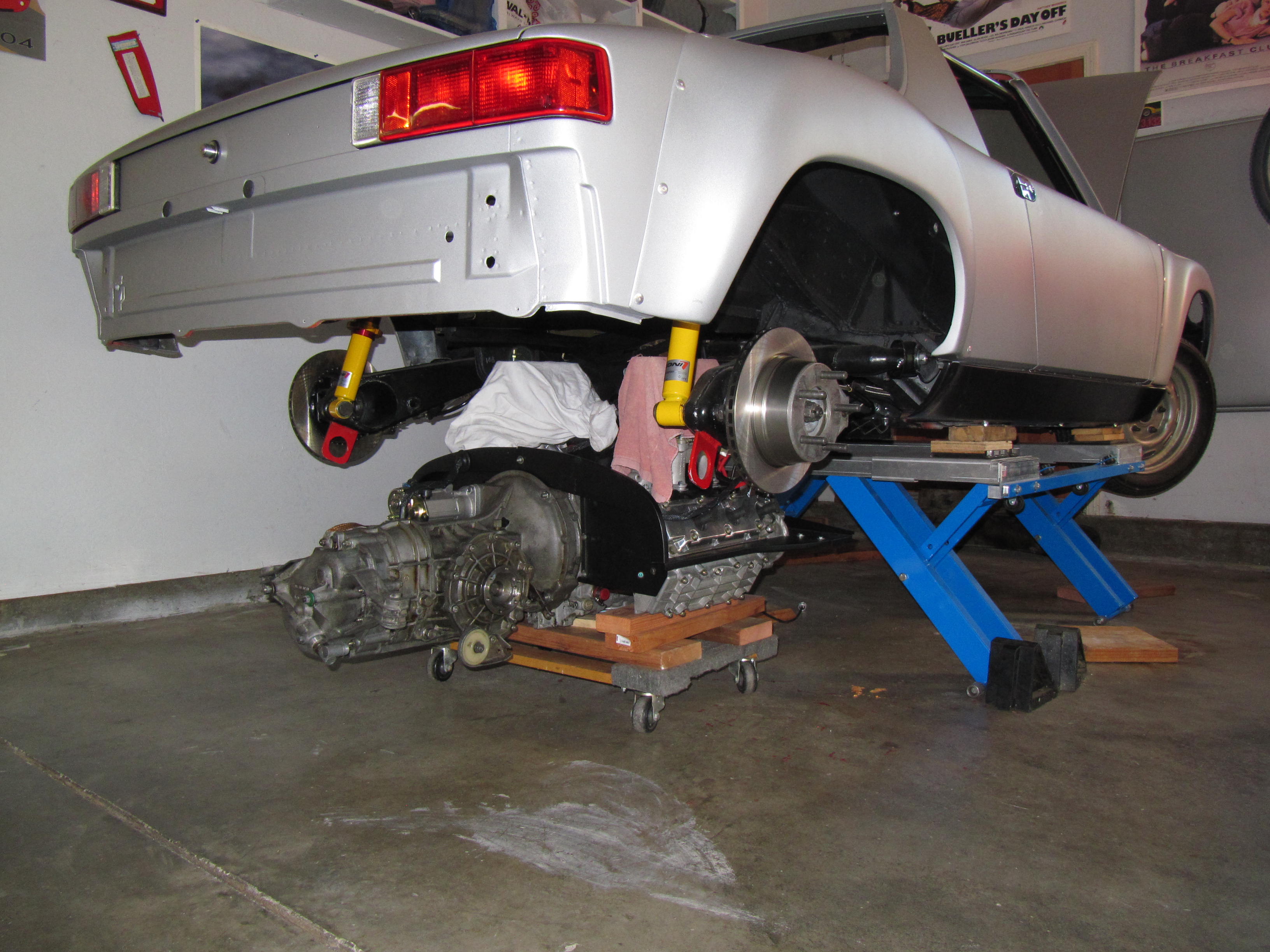

Engine/trans going in!

Krieger   Engine/trans going in!   Jun 24 2012, 12:28 PM
Krieger   Bingo!! :Qarl: :Qarl: :Qarl: Note the ...   Jun 24 2012, 12:30 PM
