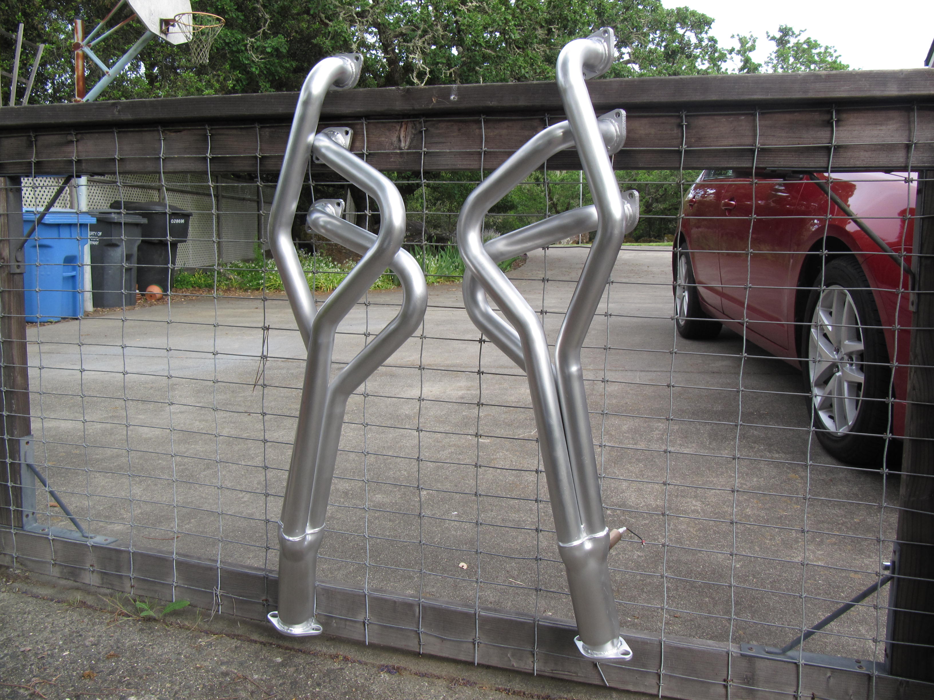

MSDS 1 1/2" headers ceramic coated. I am using the stock SC muffler for now. Bungs added for an oxygen sensor in both.

Krieger   MSDS 1 1/2" headers ceramic coated. I am usi...   Jun 24 2012, 12:52 PM
