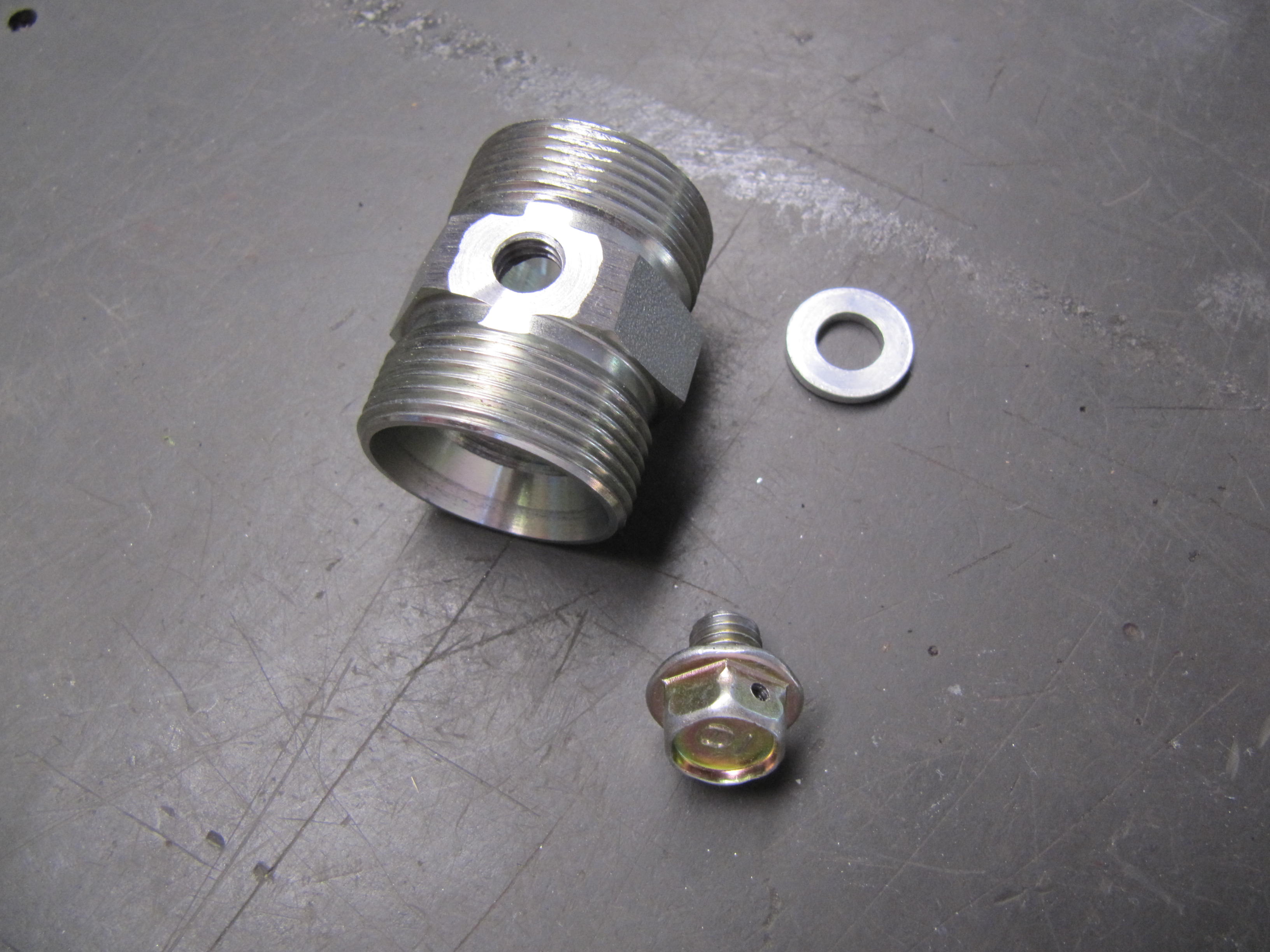

I came up with a creative solution for an oil tank drain plug. I ordered the factory oil lines from the the tank to the cooler. It came with a union. I had a face machined then drilled and tapped it for a drain plug. I drilled the plug so I could safety wire it. This is one of many parts my pal Dean machined for me.
