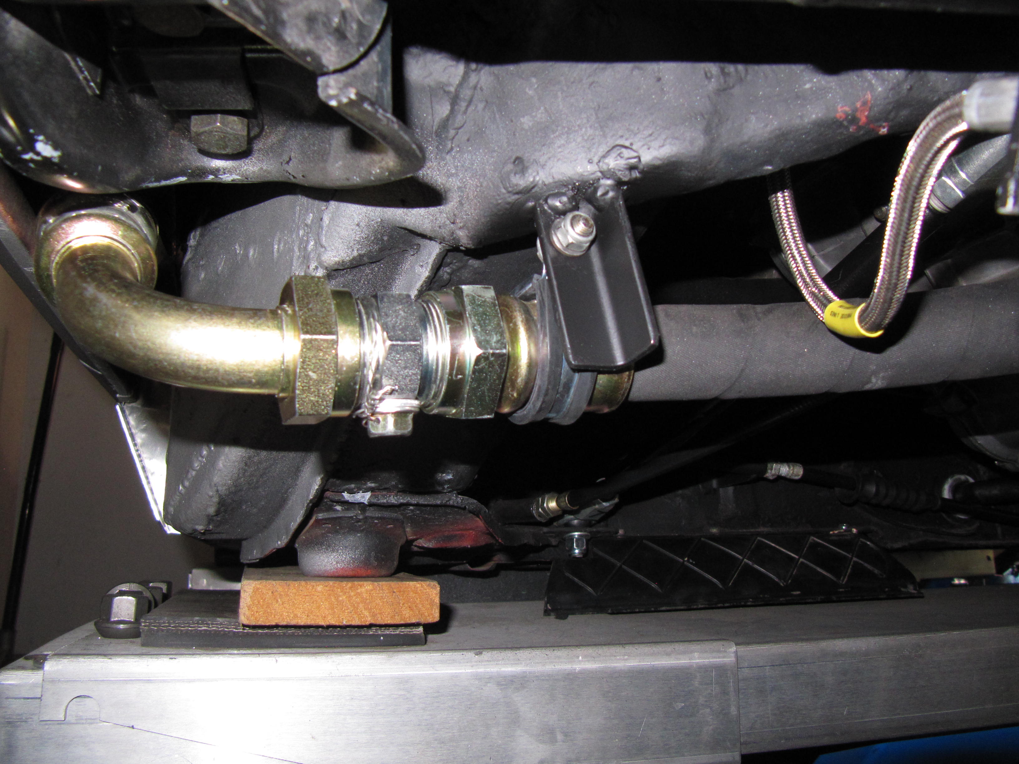

Installed. I welded in a bracket to support the set up. One large adele clamp to hold it.
Krieger   My 72 3.0 progress thread: Project F-914   Sep 24 2010, 08:48 PM

Krieger   Installed. I welded in a bracket to support the s...   Jun 24 2012, 01:01 PM
