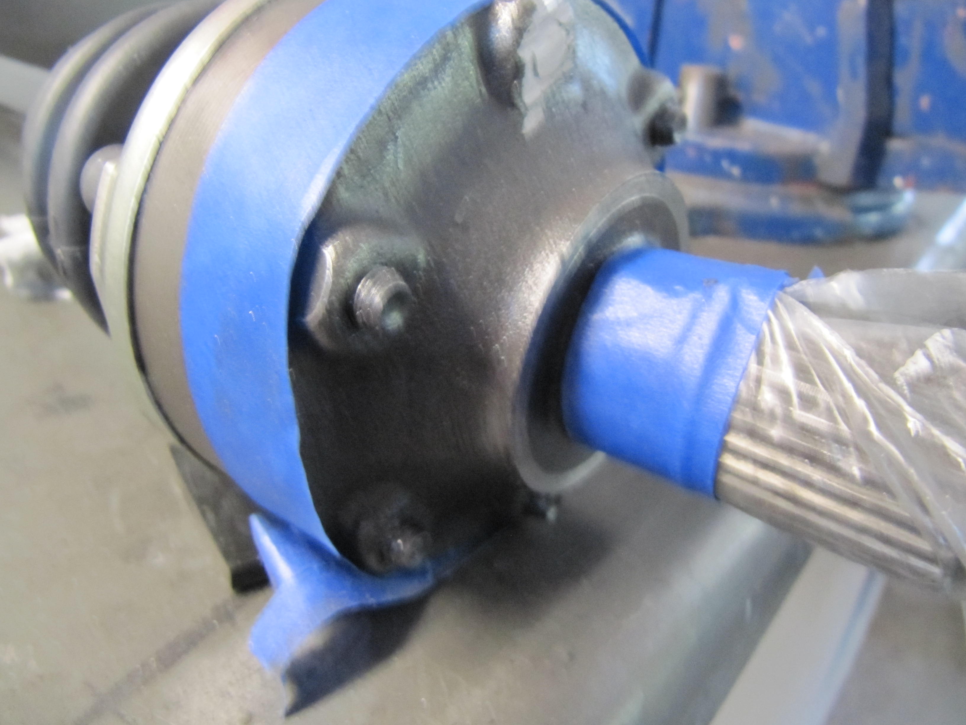

Sir Andy style axles. I needed loger CV bolts than the 45mm units that came with the 944 cvs. These are 55mm and need to be trimmed so they didn't interfere with the trailing arm. Not an issue on the trans flange side. I couldn't find appropriate 50mm bolts. Also note Sir Andy inspired picture quality. (IMG:style_emoticons/default/biggrin.gif)
