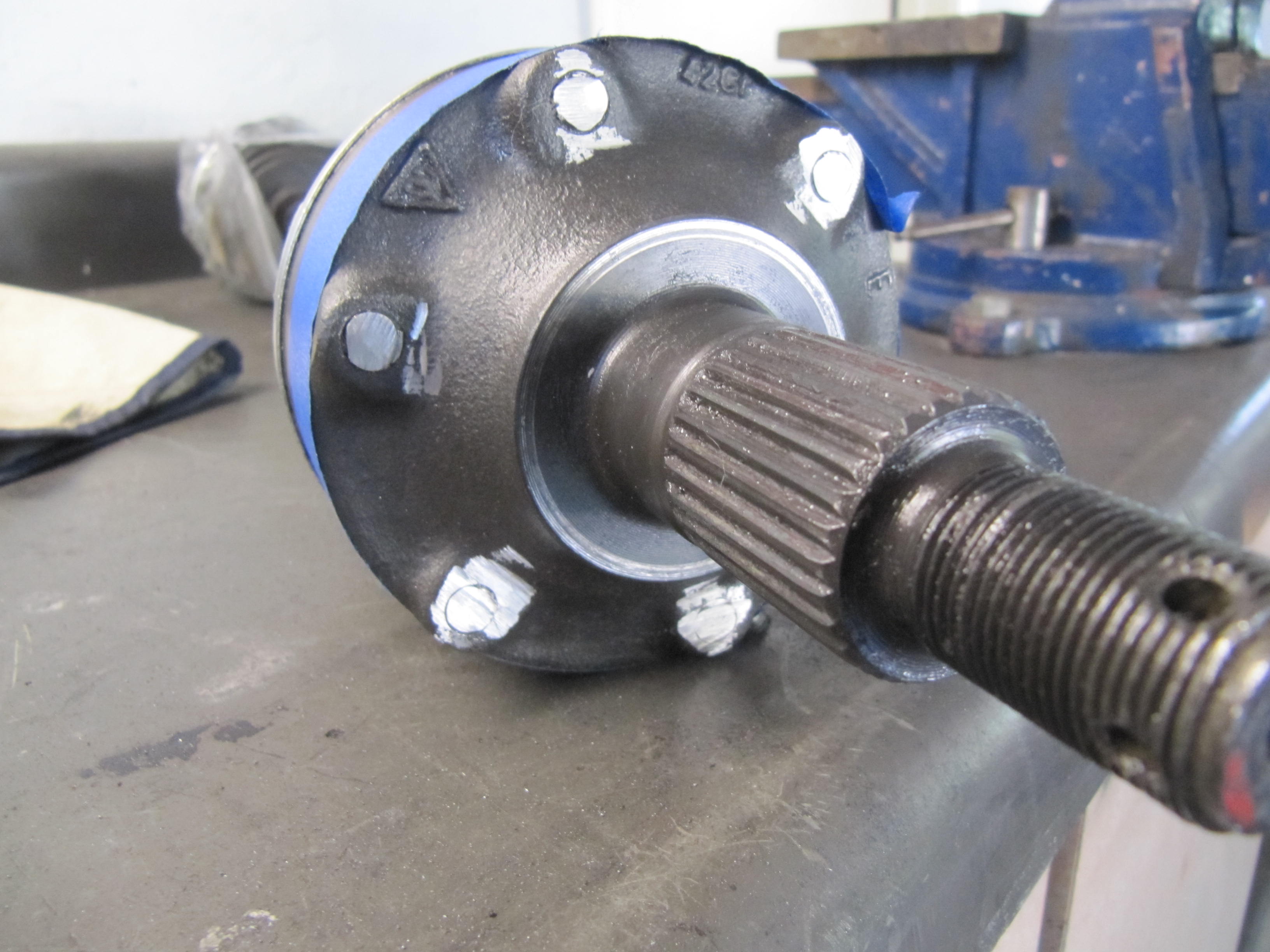

Krieger   Sir Andy style axles. I needed loger CV bolts tha...   Jun 24 2012, 01:05 PM
