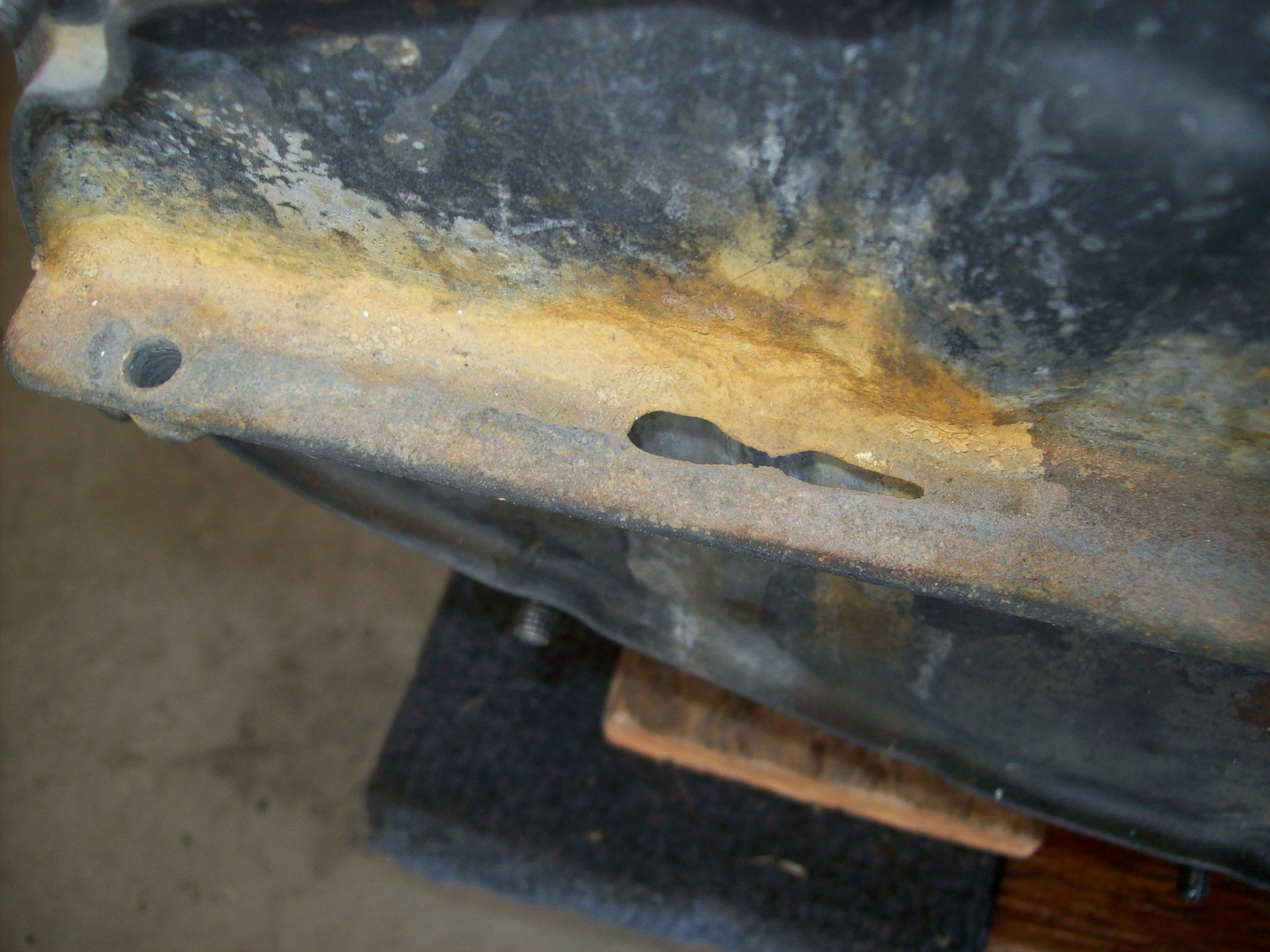

Spent a couple hours going through by baggies of parts and organizing. The chain cover housings on the 2.0 which is getting "pickled" needed a couple studs (missing) so I decided to pull them off to do a repair correctly. Looking at the lip for attacching the sheet metal ...and what do you know? That battery acid is tough stuff!
It ate right though the lip...damn!

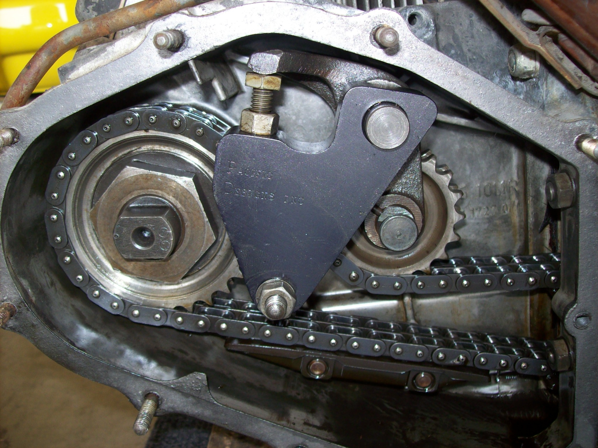

I have extra covers, so when I removed it to to the stud replacement, I noticed these...
Race tensioners...or solid tensioners...whatever. Interesting. The PO flogged this thing regularly...not on the track, but as I mentioned in auto cross. And the underside is cone dented in many places as testament. I will show the carnage when it is floating on the rotisserie. Notwithstanding...when I eventually go through the 2.0, I will be curious to see what tweeks the engine experienced over it's life. Same to be said for t-bars and springs etc. Anyway...interesting to see the tensioners. Shows me the PO went through a lot of valve cover gaskets while adjusting those puppies.
