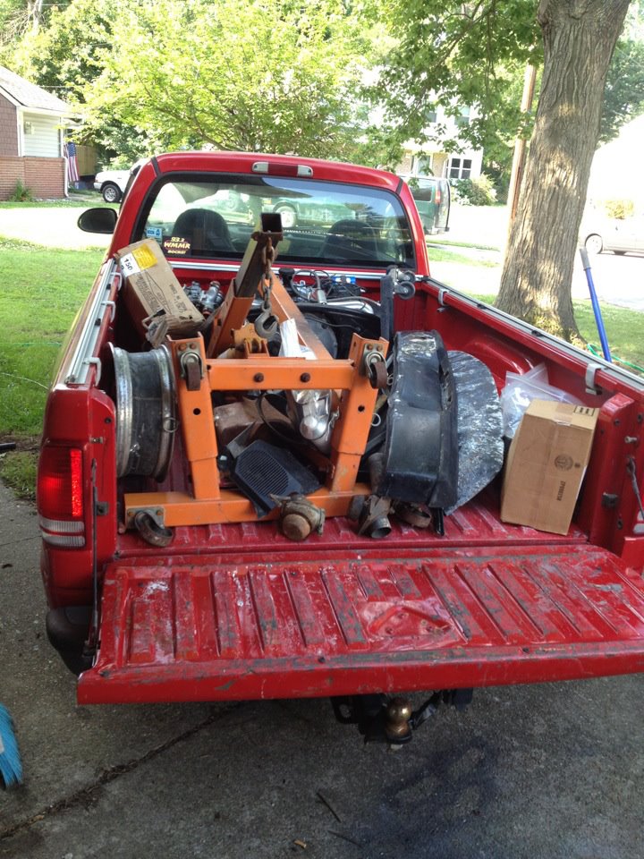

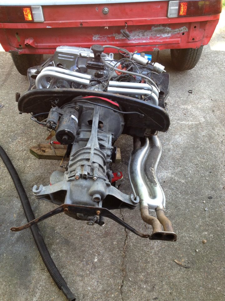

I finished welding in the seat supports and kinda ran out of stuff to do Saturday so drove down to my dads and got the engine and some more parts. I was able to get the engine installed this morning however I'm missing a few things such as the bolts for the CV shafts. Thats what I get for being in a rush to get back on the road before a storm hit. With any luck my sand paper should come in tomorrow and I can start on the body work. I would like to have the car ready for paint by this weekend but I know I'm going to realize i'm missing stuff so most likely I'll end up having to drive back to his house which could delay me painting it.
